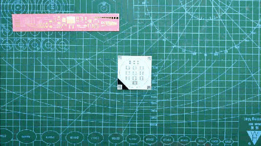

Step 2: PCB DESIGN
After finalizing this schematic, I converted it into a Board file and prepared a simple square PCB with a dimension of 50mm.
I placed LEDs and all componenets in a circle of dia 40mm.
The reason for doing this was, I plan to add an enclosure on this PCB which will cover the whole board except for the circular part.
I connected all the componenets with a 1mm width track and then exported the Gerber data before checking it one last time.

After finalizing the PCB, I sent it to PCBWAY for samples.
I choose white Soldermask for this project as WS2812B is white in color and white soldermask looks great in general.
I received the PCBs in a week which was super fast.
As for the overall quality, it was truly awesome. I ordered 20 boards and each board was perfect.
Been using their service for a while now and I have to say, PCBs that I got was great as expected!

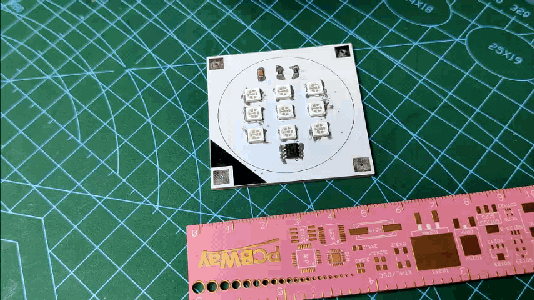

Step 5: SOLDER PASTE
The first step is to add solder paste to each component pad one by one.
To Apply solder paste, I'm using a Solderpaste Dispensing Needle with a Wide syringe, and the solder paste I'm using is a regular solder paste consisting of 63% Tin and 37% Lead.
Step 6: PICK & PLACE PROCESS
After carefully applying Solderpaste we move on to the next step which is to add componenets to their assigned location.
This one is simple, we lift each component and place them in their assigned location with the right polarity, this is crucial in the case of IC and LEDs.
Step 7: HOTPLATE REFLOW
After the "Pick & Place Process", I carefully lifted the whole circuit board and place it on my DIY SMT Hotplate.
I made this Hotplate especially for making projects like these which require SMD soldering. hotplate available in the market were not exactly cheap so I made a minimal version of that which you can check out from here-
https://www.instructables.com/DIY-SMT-Hotplate-Project/
the hotplate heats the PCB from below up to the solder paste melting temp, as soon as the PCB reaches that temp, solder paste melts and all the components get soldered to their pads.

Step 10: Problem 101
Apparently, I didnt see the WS2811 IC Datasheet properly and it stated in it that it can only drive LEDs up to 20mA which totally exceeds my setup which was over the 20mA threshold.
Because of this issue, the IC caught fire and burn out as soon as I supplied it with 12V input.
To rectify this issue, I removed the LEDs that were in series so I could power this setup from 5V instead of 12V.
I added jumper wires to connect tracks for each led that has been removed to complete the circuit and then tested this board again with the same wiring diagram and this time it did work.

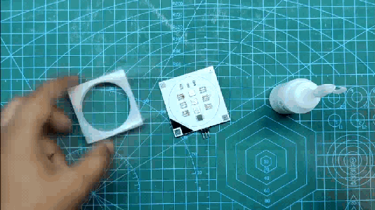

After making sure that the pixel is working, I then move on to the next step which was to prepare and print an enclosure for this board.
Step 12: 3D Enclosure
As for the Main Body of this Project, I prepared a body based on the existing WS2812 Design which is a Square shape body with a circle in the middle and a notch at the ground pin side.
I prepared the model in fusion360 and exported its mesh file so I could print it on my ender 3 with a 0.3mm Nozzle at 0.2mm layer height.
I then 3D printed the body and added it to the main PCB with super glue.
