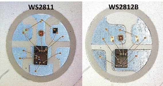

Step 2: Difference
The WS2812 neopixel has 6 pins and six internal pads while the WS2812B neopixel has 4 pins and 4 internal pads as shown in the pictures.
Step 3: Advantages of WS2812B to WS2812
1. The reduced number of pins reduces the chances of short circuiting
2. Since there are fewer internal pads, the WS2812B dissipates heat better reducing chances of over heating

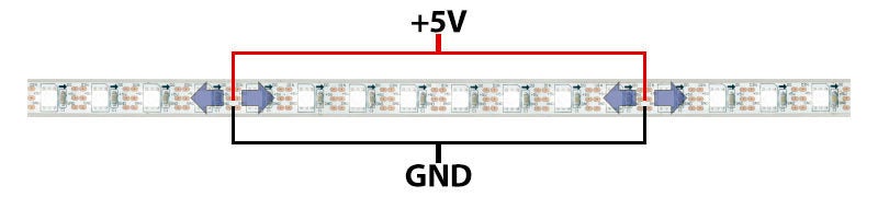

Step 6: Powering Many Neopixels
To run many neopixels from the same power supply you need to use a parallel connection as shown in the diagram. It is important to get the connection right otherwise you will burn the neopixels.
