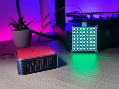

Step 8: Project Results
Below we have images of the RGB LEDs being controlled via the WiFi controller with WLED firmware. We selected 3 different colors to show the result.
As you can see, the system worked with satisfactory results and you can place your Addressable RGB LED strip or matrix to be controlled via WiFi.
