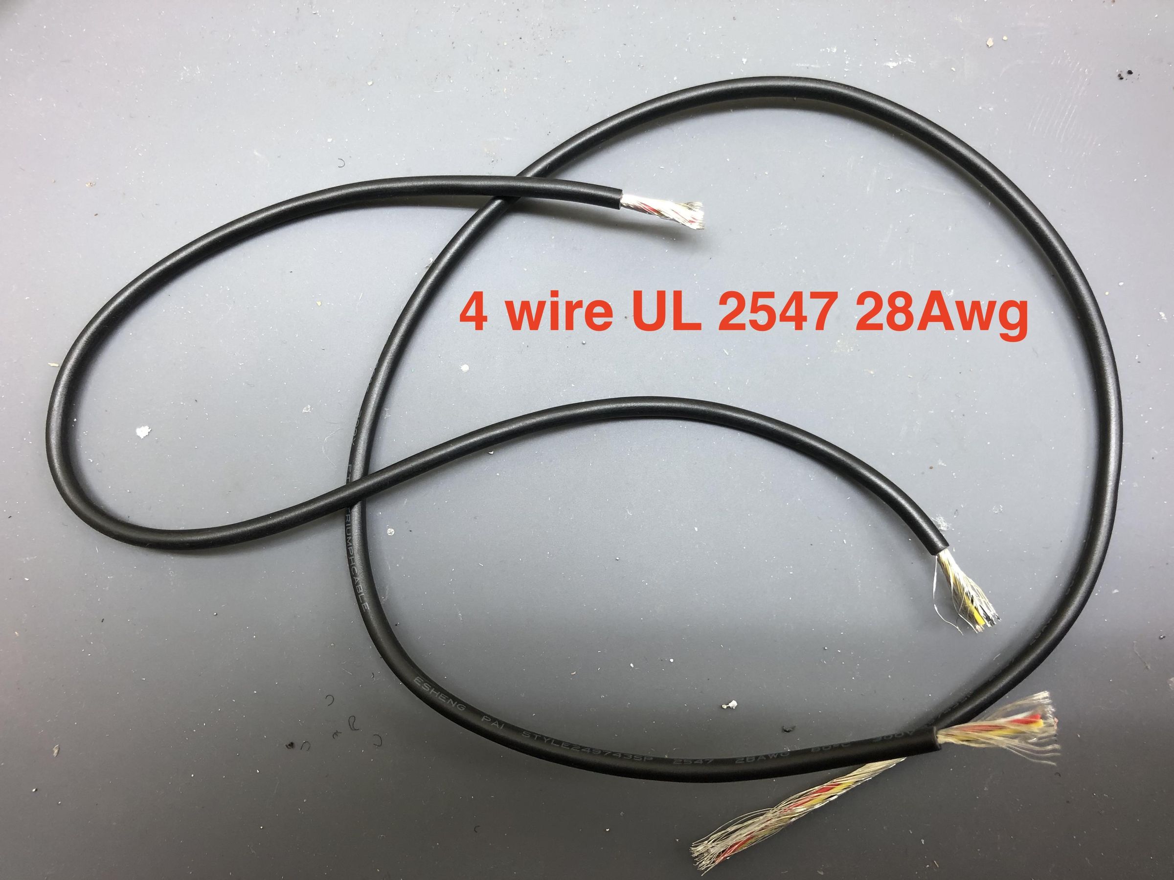

The GPS module comes without cables or connectors. I added a 4 pin XH2.54 90 degree connector so that I can easily swap out the GPS module as needed. The cable therefore has a 4 pin female XH2.54 connector on one end and individual female Dupont connectors on the other.
For the antenna I use a WWVB receiver module. Rather than disconnect the antenna from the module, I just glom onto the antenna connection (the antenna pad closest to the center of the board) and the GND connection. The wire used is UL 2547 multi conductor audio wire that has a ground shield (e.g. headphone wire.) On the other end I attached female Dupont connectors with heat shrink tubing used to insulate the bare GND wire.
I generally make cables with female connectors for breadboarding and use 15mm breakaway headers with equal pin lengths to connect the female connectors to the breadboard. This way if I have to leave a connector disconnected you don’t have a bare pin floating around.

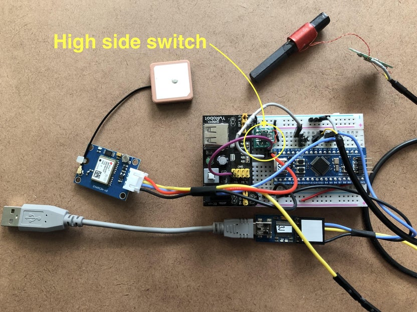

Step 3: Assemble the Project
Assemble the project:
  • Insert the BluePill+ module on the breadboard as shown in the picture.
  • Insert the breadboard power supply module as shown in the picture.
  • Set the jumpers to supply 3.3V to both supply rails on the breadboard.
  • Attach jumper wires for power and ground to power the BluePill+ module.
  • Connect the GPS module
  • GPS VCC to +5V directly to the breadboard power supply header
Optional:

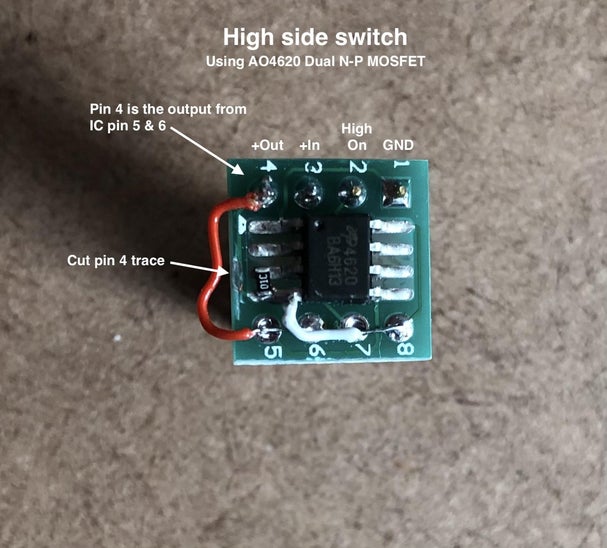

Use a high side switch to control power to the GPS module. Following the schematic, build the switch using an N-channel MOSFET and a P-channel MOSFET. I used an AO4620 IC that has an N-channel and a P-channel MOSFET in a SOP8 package. The AO4620 IC is mounted to a SOP8 to DIP8 adapter board with a 4 pin header only on one side.
Pin B10 on the BluePill+ is connected to a jumper that contains a 220 ohm resistor. The other end connects to pin 2 of the DIP8 adaptor board. GND is connected to pin 1, 5V is connected to pin 3, and pin 4 is connected to VCC on the GPS module.

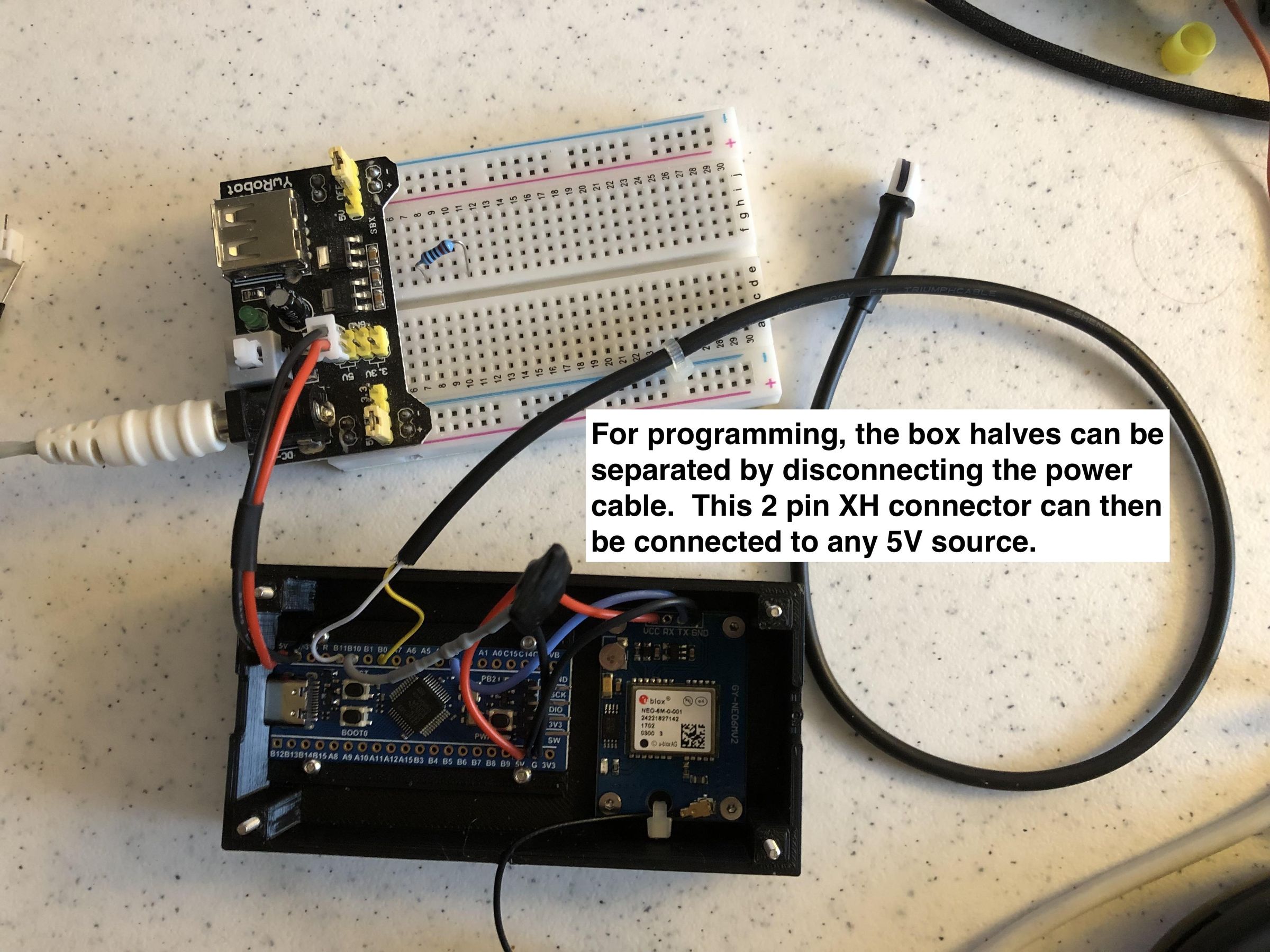

Step 5: Implementation Example

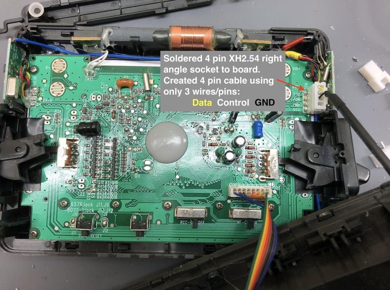

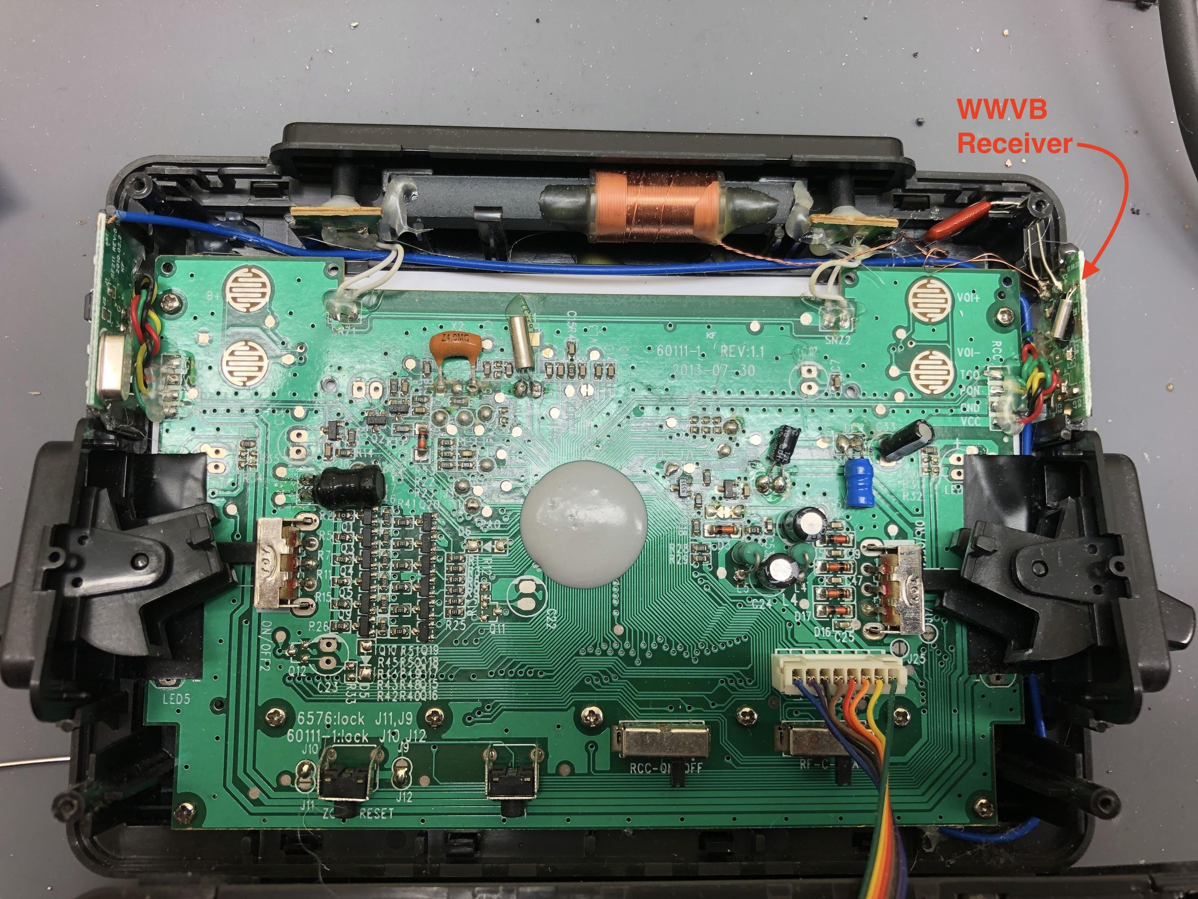

In this example I converted my Acurite clock model 13035W to use GPS as the time source rather than WWVB. This example will also work on model 13024.
This Acurite clock updates/synchronizes its time at midnight. If it’s unsuccessful it will attempt to synchronize again at 1, 2, and 3AM before it gives up for 24 hours.

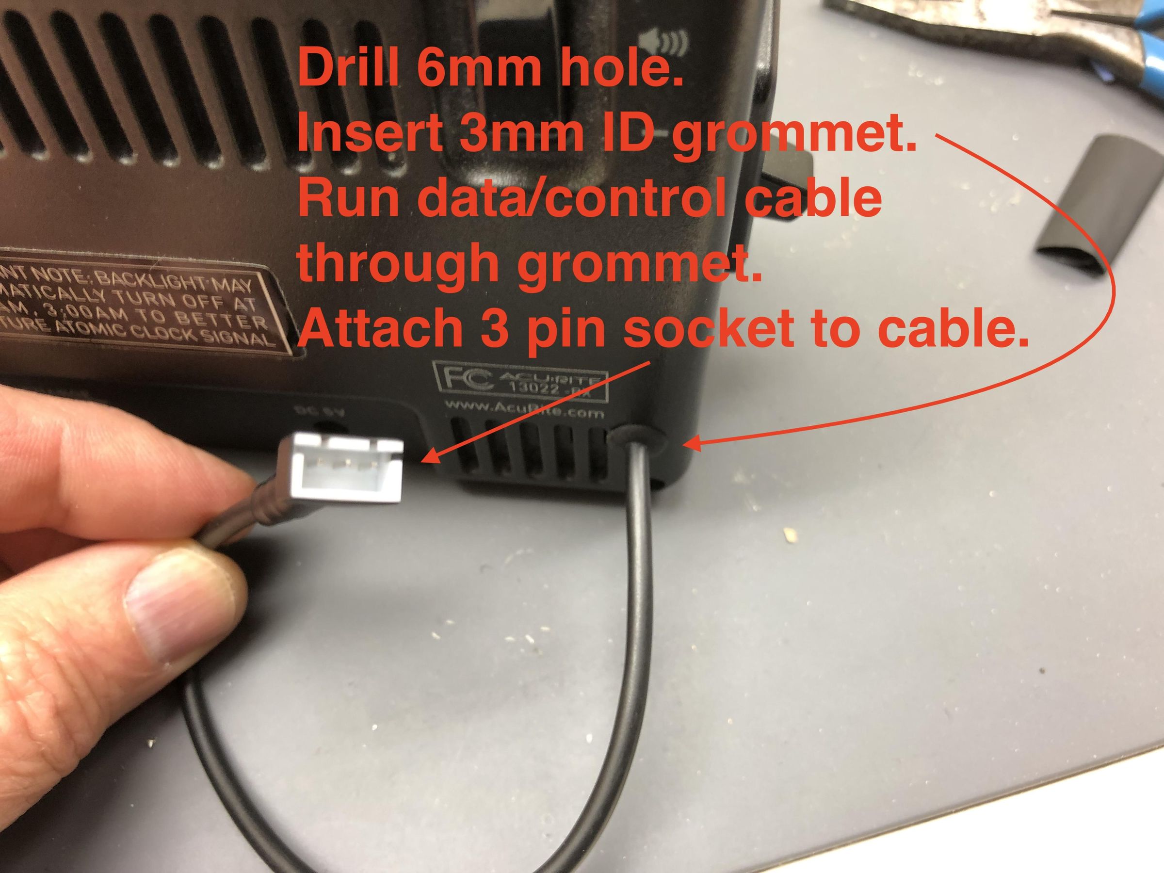

The conversion simulates the output of the clock's WWVB receiver module. The receiver is connected to the clock main board with 4 wires: GND, 3.3V, data and control. Control is an input to the receiver. When this signal is low the data line is active. When this signal is high the receiver is in an inactive low power standby state.
I made a few minor changes to the WWVB simulator code:
- The PWM timer used to modulate the 50KHz signal previously output on PA6 is no longer used so it and the associated hardware/code was removed.
- The debug signal output on PB0 was inverted and is used as the data line (yellow wire) to the clock.
- A “pin changed” interrupt was added to monitor the control line coming from the clock (PB11 white wire.) The state of this pin determines if the data line is active.
- For debugging, the button labeled “KEY” on the BluePill+ now initiates an update from the GPS board. This is the same update that happens when the BluePill+ is restarted and on the half hour.
I designed a very simple box to house the UPS, BluePill+ and the GPS module.
This example also adds a 5 volt UPS to power the clock for several days if you loose power. I found the UPS module on AliExpress for $2. This UPS module requires two 18650 batteries.
If anyone would like the code changes and/or 3D STL files used in this example, send me a message with your email address.
