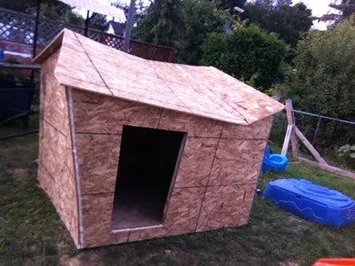

Step 2: Construction
I made my base out of 1/2" plywood and 2x4" pressure treated material. One sheet will do for the base, make any size or shape you like. Mine is 4' wide, 6' at the front and 5' at the back. Glue and screw the 2x4" as a perimeter under the plywood and joists at 2' centres.

Step 4: Roof Construction
To build the roof, I installed two supports at the end walls. One side I added an extra cut to allow that wall to 'bend'. My roof ridge consists of a single 2x4" with one cut and reassembled to create an 'out of line', wacky roof line. I did this with the top of the wall on the front side so that things did not look too straight. Add rafters as needed. You should have a rafter at each hip and valley(where the cuts are in ridge and wall plates), and recommended not farther than 2'.
Step 5: Sheeting
To sheet the walls and roof I used 1/2" aspenite. It is a crappy building material, but seeing as it was free, it works perfectly. 1/2" plywood would be recommended. Due to the changing and irregular shape of the walls, start in one corner, and work outwards across the sheet. I used screws on everything as they should hold better than nails and you can snug the sheet in better. Use full sheets where possible and install as full sheets. Once the sheet is secured and in its final place trim using a skilsaw along the framing. This way no measuring needs to be done and no funky angles need to be figured out.
The roof sheeting and end wall that 'bends' will need to be sheeted in multiple pieces as one sheet cannot bend in such a manner. Again due to the irregular shape, start in one corner and work out from there. You may have to use more screws closer together and work them in together to pull the sheet in to the framing without popping through the sheeting.

Step 6: Doors and Windows
To add in your doors and windows, once that particular wall is sheeted, draw the shape of your opening on the wall and cut it right out. The cutout will become the door or window. Add on hinges and a handle and this step is done.
