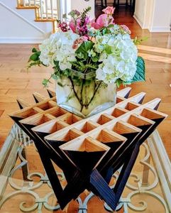

I used a Japanese wood finishing technique called shou sugi ban (or Yakisugi) which involves torching wood to a char then scrapping it off. I did this on 2 sides of the struts. So nice.

I thought this step would be easy but it was a lot of work to get things fitted snugly. I added each bottom triangle one at a time to the top waffle section and inserted the splines, glued up, and reinforced with a bunch of rubber bands and clamps.
Here I wished I had octopus arms to speed things up but eventually I was able to get it all together.
Just needed to trim off the shims and apply a finish.
Step 9: Fin
Turned out Pretty Pretty Pretty Cool don't you think. I really liked the top part being light and the sides dark.
