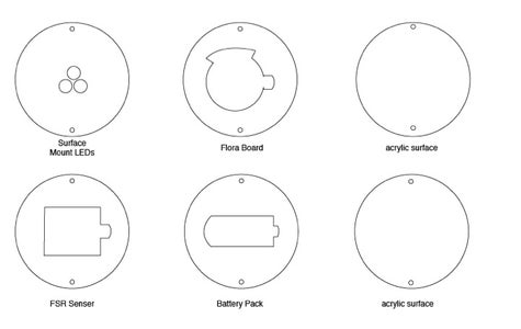

Step 2: Draw and Sketch Out the Parts

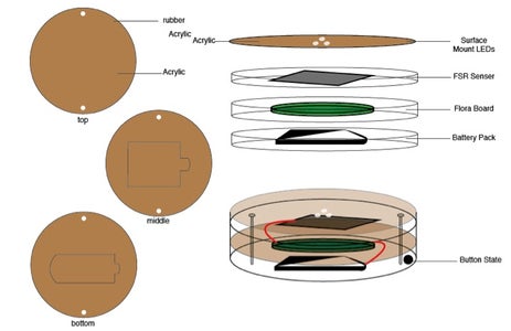

I began by drawing out several sketches of what I would need to build the coaster.
First I created a diagram of how I wanted to house and layer of the electronic parts inside of the coaster. I did this using the below illustrator file. Each of the parts are sized to scale.
Then I created a storyboard outlining step-by-step how I want a user to interact with it. In each instance I discovered that I would have to make adjustments to my original diagram like including a space for a button, a USB port and external access to the battery power. Edit the file for own purposes. Once you feel like you have all the necessary parts, print them out.
*Note: in the final version the FSR sensor is located on the bottom of the coaster and the battery and flora board are housed on the same level

I used a band saw to cut out  two 24in X 12in pieces of wood. Once with 1/4in wood and then again with 1/8in wood. I used the thick pieces of wood as the base for each level and the thinner pieces as the middle layers.
Once you have all the pieces, place the corresponding components in their housing. Each part should fit snuggly in their cut outs so that they don't move. Then layer one of the thin circular cut outs on top of each layer like a cake. You can use a glue gun, wood glue or crazy glue to adhere the rings to each base piece.

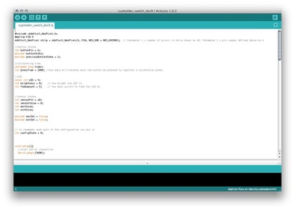

Step 5: Upload the Code
My research showed that my coaster has to account for at least 5 unique glass types, so I wrote the code to calibrate the weight of the glass to the coaster. When a full glass is placed on the coaster and the button located at base of the coaster is held down for three seconds, the coaster registers a maximum weight. When you release the button and place a half full glass on the coaster it registers a minimum weight. Then the coaster does some math and will recognize when you glass in nearly empty. When it registers this change in weight (via the FSR sensor) the LEDs will begin to “breath” – alerting a bartender that you need help.
I've tried uploading the code but its not working so i've pasted in the code below:

I'm having trouble with the programming so if any of you have any recommendations or have calibrated buttons before, I will be very appreciative.
