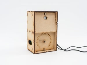

Introduction: Wake Up Clock
What time is it? It’s wake up time! We’ll explore the Intel® Galileo Gen 2 board’s real time clock (RTC).
The RTC, once set up, will run even if the board is turned off so long as it gets power from the attached battery. While this is a relatively simple function of the board, it has its obvious uses - scheduling, timing, or calculating intervals.
We will be making a “wake up clock” which will turn on and illuminate the room slowly, simulating a morning sunrise. Hopefully, it will make waking up on Mondays a bit easier.

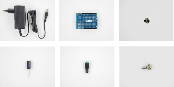

Step 1: Needed Components and Tools
- Intel® Galileo Gen 2
- Intel® Galileo Gen 2 power supply
- Arduino Protoshield
- LED power supply
- 1 High power white LED(3v 700mA)
- 1 1000 μF Capacitor
- 1 2.1 mm DC jack-to-screw terminal adaptor
- 1 10k potentiometer
- 1 1.8Ohm 2w resistor
- 1 LM317t voltage regulator
- 2 10kOhm resistor
- 1 2n7000 transistor

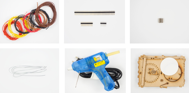

- 1 Coin battery holder Jumper wires
- Colored wire
- Pin header
- 1 8 mm magnet
- Stiff wire (that is attracted to magnets)
- Wood glue
- Hot glue sticks
- 4 mm MDF components - lasercut according to drawing
- Plexiglas components - lasercut according to drawing
- Nuts and bolts
- Rubberband

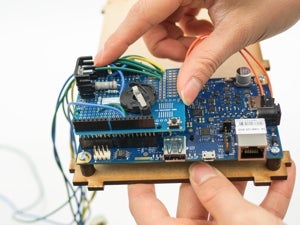

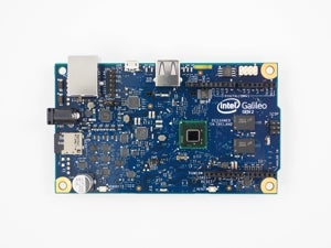

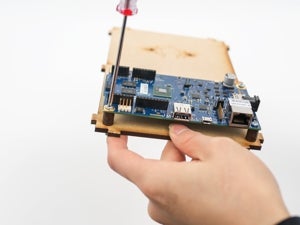

Step 5: Attach the Intel® Galileo Gen 2 Board
Use parts B4 as spacers for the board.

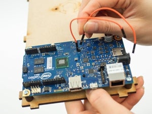

Step 6: Connect the Intel® Galileo Gen 2 Board
- Connect two jumper wires to the two pin headers
- Connect the protoshield to the Intel® Galileo Gen 2 board

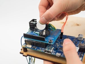

- Connect the power to the RTC
- Connect the two jumper wires from the Intel® Galileo Gen 2 board to the protoshield assembly
- Insert the coin battery

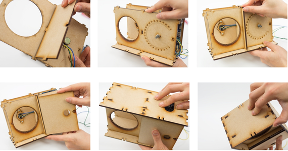

Step 9: Assemble the Whole Case Pt1
- Attach Part A5 to Part A9
- Attach Part A8 and Part A9 to Part A6
- Attach Part A3 to Part A6
- Insert Part A4 to Part A6
- Place Part A7 onto assembly
- Place Part A1 onto assembly

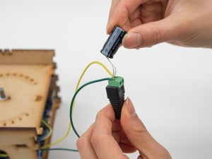

- Connect the terminal adaptor
- Insert the positive and negative leads into the adaptor
- Insert the 1000 μF capacitor and tighten screws to secure

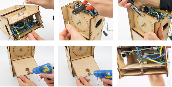

Step 10: Assemble the Whole Case Pt2

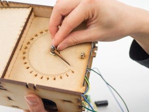

- Place the alarm dial onto the face of the clock
- Insert the potentiometer through the hole on Part A9. Make sure to line up the stabilizing tab on the potentiometer to the small hole provided
- Screw on the locking nut
- Slip Part B1 onto the potentiometer knob
- Install the magnetic switch
- Push the wires through the holes at the bottom of Part A9
- Cut off excess wire
- Bend the wires back through the hole
- Attach Part B3 to Part A4 where indicated

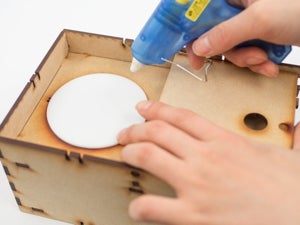

- Glue the magnet into the hole
- Make sure that both wires touch the magnet
- Note: It helps if the wires can slide loosely in and out so that both will make contact with the magnet
Step 11: Assemble the Whole Case Pt3
- Place the dial and Plexiglass cover
- Slide Part B1 on the potentiometer
- Glue the Part C1 onto Part A9

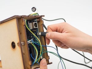

- Attach the power cables and USB to program the board
- Detach the USB and close the clock
- Attach Part A2 to the assembly
