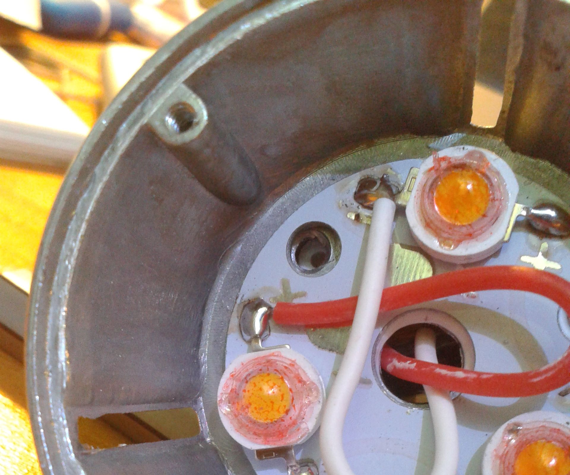

- 10W 9-12V 0.9A Warm White COB LED (ebay, 1,31 dollar)
- 10W 9-12V 0.9A White COB LED (ebay, 1.40 dollar)

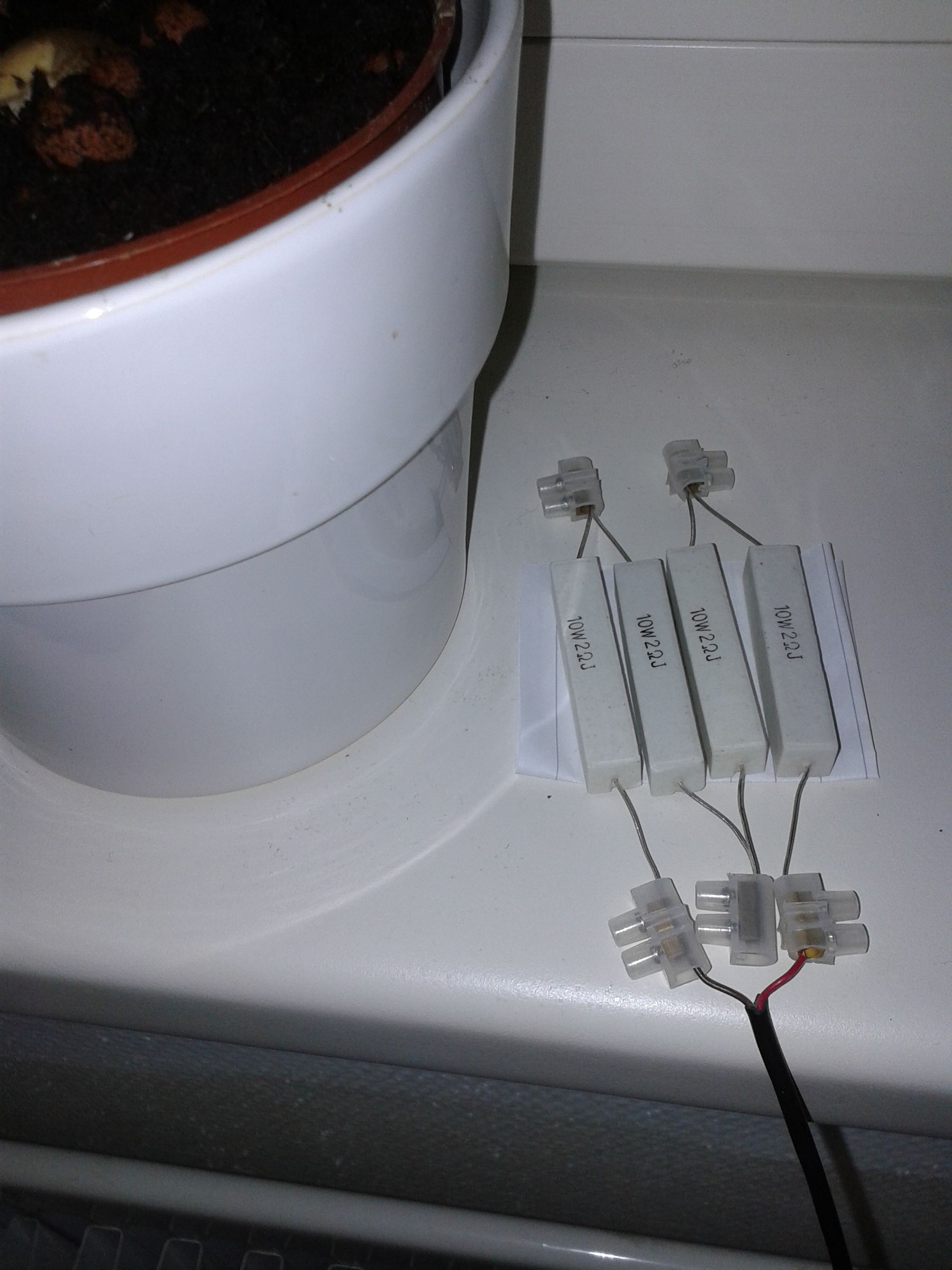

- 2 Ohm 10W resistor (ebay, about 3 dollars for a 5 pack)

The circuit was first tested with a lot of different setups on a breadboard, until this one was found which I was happy with. Test your circuit and make sure the components don't heat up to much. Don't test for just a few minutes, let it run for an hour or so. If some things get hot, make sure they are close to the heatsink and attached to it with the thermal glue. With my setup the 150 Ohm (~2W?) in series with the fan got quite hot, so when I was testing I placed a piece of scrap copper against it to remove excess heat. Worked quite ok. Conclusion is, this resistor needs to be a bigger one (as in actual size/Watts it can handle) or be attached to the heatsink. The 2Ohm 10W also heats up a lot, though it should be able to handle this. Nonetheless I glued it to the heatsink. The mosfet also heats up quite a bit, this one should also be attached to the heatsink!
I somehow partially destroyed my warm white LED, probably when melting the shrinktube around it's terminals. The LEDs consist of 3 strings of 3 LEDs in series, and one of the strings died. So basically I now have 5 strings of 3 LEDs, of which 2 are warm white and 3 are cool white. Therefore maximum amperage goes down a bit, its now 0.9+0.6=1.5A. I could replace it, but I don't feel like doing so.
