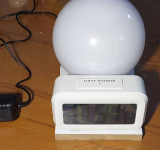

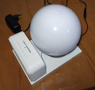

We have made a wake-up light using an Arduino board,12W LED and a 12V power supply. A wake-up light alarm clock uses gradually increasing light—often paired with gentle sounds—to simulate a natural sunrise. Instead of an abrupt buzzer, it eases you awake by aligning with your body’s circadian rhythm, helping reduce grogginess and stress.

We used an Arduino board to fade the 12W LED light. This is the parts list:
- Table digital clock
- Arduino board
- 12V power supply
- IRFZ44N Mosfet
- 4K resistor R1
- Buzzer
Step 1: Connecting Clock to Arduino
I just detached the original buzzer inside the table clock and connected the pins to Arduino board. The code is self explanatory.
