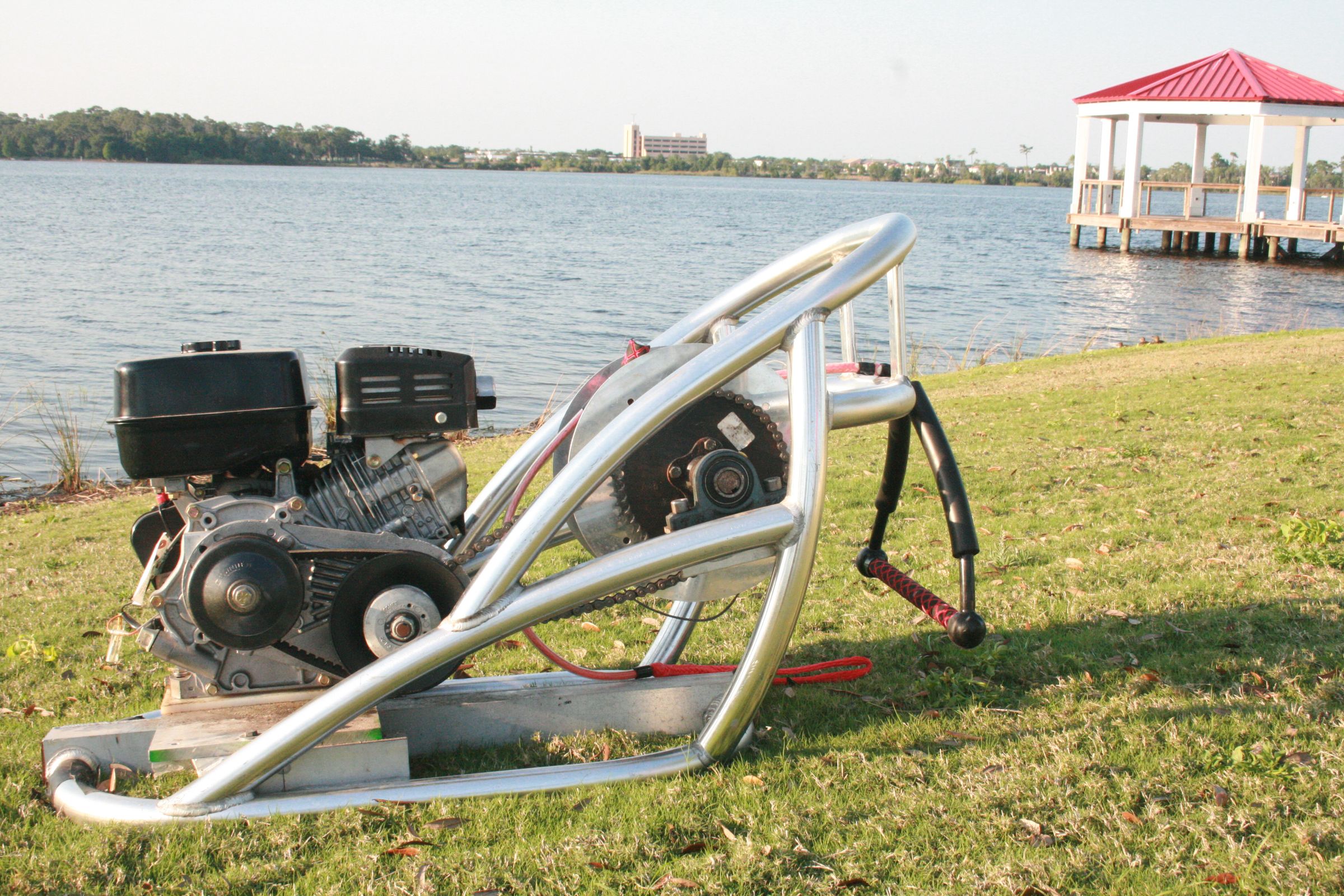

FRAME: For my frame I wanted to get away from the standard of using steel and boxy shapes. Steel square tubing is cheap and easy to work but is also heavy and limiting from a design perspective. I went with round aluminum tubing. Aluminum is light, rust resistant (for those fun beach runs) and shines up nicely in the sun. I bent the tube on a borrowed hydraulic roller and came up with a design that looks like a boat tower on a ski boat, I feel it relates to the roots of wake sports.
SPOOL:Instead of using an old go kart wheel hub or spare parts I fashioned my spool out of aluminum and cut it on a CNC. The various holes give me different diameters for the line to go on, different diameters allow the rider flexibility in the tow.
LINE: High tensile strength and low specific gravity are the two most important factors when choosing line, this way its strong and floats. Spectra or Dyneema are two types that fit the bill. I ordered mine from over seas and saved a few bucks.
POWER: While I started out with the traditional 6.5 hp engine I went up to 9hp Robin Subaru engine for more RPM’s , power and longer engine life. Many builders make a transmission system out of a centrifugal clutch, sprockets, bearings and chain but I chose to go with a Torq a verter from Comet Industries (also called TAV2 or CVT). Again not the most cost effective choice but as far as performance goes it cant be beat. Make sure and get one that matches your engine bore size.
