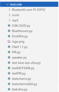

  1. I powered the Raspberry Pi and used Python scripts to read sensor data and activate outputs
  2. Each sensor was verified in isolation, then as part of the full system
  3. Data from pressure sensors was read via the MCP3008 and printed to the terminal
  4. The OLED displayed system information (e.g. IP address)
  5. The LED ring ran basic animations
  6. The buzzer was triggered based on button presses or simulated alarm conditions
ESP32 Bluetooth testing:
The ESP32 was programmed using PlatformIO, which allowed better project structure and easier dependency management.
  1. The ESP32 advertised itself as a Bluetooth serial device
  2. I connected it to the Raspberry Pi via Bluetooth
  3. Python on the Pi established a serial connection to send and receive test messages
All testing scripts used during this phase are available in my GitHub repository:
View test code on GitHub

Code integration
Each of the separate test scripts (from earlier steps) was refactored into a unified loop in app.py:
  1. Created modular functions: read_pressure(), read_motion(), detect_obstacle(), etc.
  2. Each reading was written directly to the database via the backend
  3. The system detected alarm start/stop conditions based on sensor values and time
  4. Status updates were sent live to the web dashboard via socket.io
All scripts used during this phase are available in my GitHub repository:
