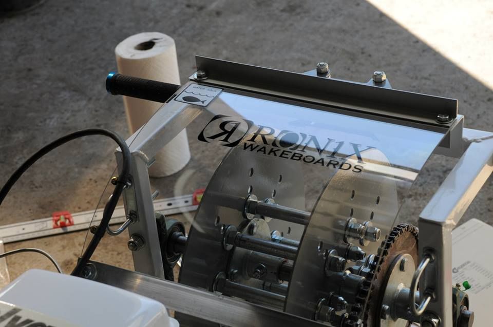

Step 4: Spool Fabrication
- cut out from a .125 in. (1/8) steel plate – settings of 6.5”, 8.5” and 10.5”
Step 5: Spool Installation

Step 7: Lexan
