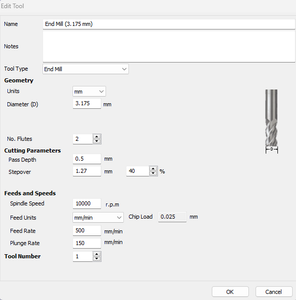

3.175mm End Mill - This was used to surface the material, to give me a flat surface to start everything from.

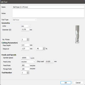

3.175mm Ball Nose End Mill - This was to rough the model's surface.

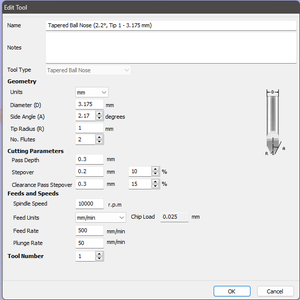

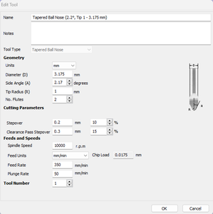

1mm Tapered Ball Nose End Mill - This was for the finish pass, you could use a finer bit, but it would take much longer and would increase the risk of snapping the bit.

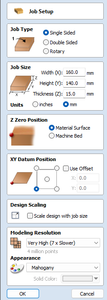

I first opened a new Aspire file, inputted my job size, and selected the 'Z Zero Position', this is either the material surface of the machine bed and is basically where the tool starts, I selected material surface as my Z Zero Position. For the XY Datum Position, I selected the bottom left, and this makes the most sense for my machine.

To start with I knew I needed to face the material to start with a flat surface. I draw a box the same size as the document. I then made a new layer, called 'Facing', and moved the rectangle to this layer. Then in the Toolpaths tab, make a Pocket Toolpath, and set your cut depth, I used 0.5mm, as I could always run it multiple times until the surface was smooth. I then selected the tool and set the speeds and feeds, (all the speeds and feeds are in the images). The last step for facing was selecting the vector, which is just selecting the 'Facing' layer we made earlier. Then we can just change the name and press calculate.

Heading back into the 'Toolpaths' tab, I first created a '3D Roughing Toolpath', selecting my 3.175mm Ball Nose Endmill as the tool, choosing 'Model Boundary' as my Machining Limit, having a machining allowance of 0.1mm and selecting both the Mainland and Anglesey for the vector selection. I then renamed it and calculated it.

The finish pass used a 1mm Tapered Ball Nose Endmill. I selected the 3D Finishing Toolpath, and the 1mm TBN Endmill, and then set the stepover of the tool at 10%, a lower stepover means a better finish, but will take longer. I also changed the boundary offset to 0.5mm to ensure all the estuary and fine details around the coast wouldn't get missed.
Profile 2
Finally, I duplicated the first profile toolpath and just changed the tool to the 1mm TBN endmill, this can get into slightly smaller places than the 3.175mm BN endmill, and also leaves a better finish.
