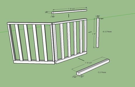

Step 2: Cutting Pieces
I used a miter saw for this project, you can use a hand saw or any other tool that you prefer, just remember to make a straight, clean and accurate cut.
To speed the process I marked and cut my first piece and I used it as reference for all the next cuts of the same type of piece. Always use security glasses when you are cutting.
Cuts:
A - 1 1/2" x 3/4" x 20" (12 Pcs.)
B - 1 1/2" x 3/4" x 22 1/2" (2 Pcs.)
C - 1 1/2" x 1 1/2" x 22 1/2" (2 Pcs.)
Steps
- Measure and mark one piece on the lumber, put on the miter and cut.
- Align the same piece with the lumber to mark the next cut, put on the miter and cut.
- Repeat to cut every piece, use the first piece to do all the marks.
- Repeat all the steps with every type of pieces (A,B and C).

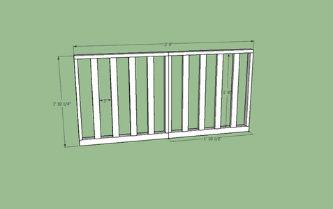

Step 5: Assembling
I used some clamps and the square to get a perfect angle. I have a framing tool but it was very hard to me trying to reach the pocket holes with the drill, you can try it. I assembled the frame first and the posts after. I used a 3" spacer between each post.
Steps:
- Clamp the base (C) of the frame on the table
- Clamp the first post (A) on the corner of the base (C) with a side face on the table and use the square to adjust.
- Drill two screws on the pockets to create a corner.
- Repeat this steps (2-3) with the next corner of the frame.
- Clamp the top of the frame (B), align with the square and drive the screws in each hole at the end.
- Put two 3" spacers in two corners of the same side of the frame, put one post (A) with the face down, align with spacers and drive the screws in each end.
- Repeat this step until every post (A) of the frame are installed.
- Repeat all the steps (1-7) to complete the second frame.
