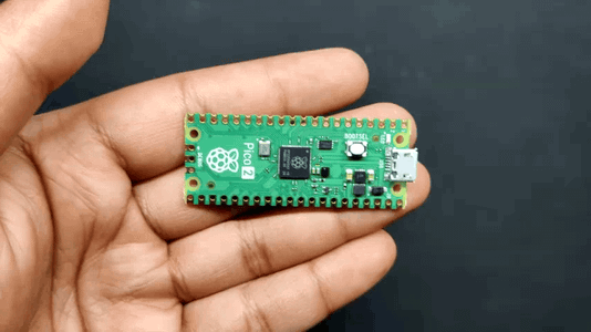

  2. Raspberry Pi PICO 2

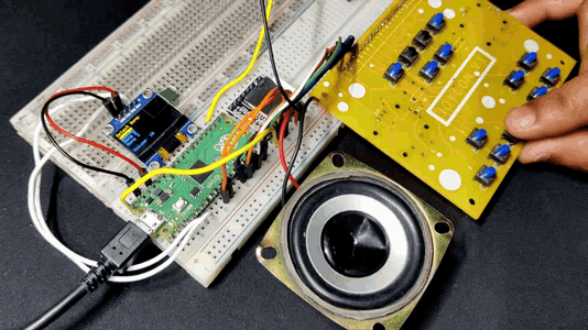

Step 1: Breadboard Setup
We already designed the WalkPi's Basic Breadboard configuration.

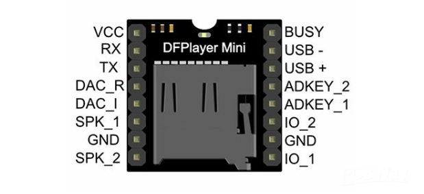

The star of this project is the DFPlayer Mini, which is a mini MP3 Player Module that is based around a 24-bit DAC IC along with an onboard SD Card reader that fully supports the FAT16 and FAT32 file systems.
The project's brain, the Raspberry Pi Pico, is connected to the DF Mini Player, a small, low-cost MP3 module with a simple output straight to the speaker.
We included the SSD1306 OLED screen to show the song list, volume settings, and other information in addition to song names.
Here's the brief article about how we setup the breadboard setup:
https://www.instructables.com/WALKPi-Breadboard-Version/
In order to simplify the design process for subsequent iterations, we evaluated all of the device's internal workings in the breadboard version, which was the first step of testing this project before proceeding to the PCB design phase.

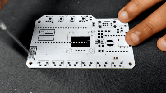

Following the creation of the schematic, we also created a mockup CAD file for the board, in which we modeled every component that we would need to install in the circuit, including the PCB, vertical push buttons, Raspberry Pi Pico, DF Mini Player, slide switch, and Type C port.
We create the board layout and arrange all the parts to complete the circle using the dimensions obtained from the Cad file.
Step 3: PCBWAY SERVICE
Following the completion of the board design, we ordered PCBs in white solder masks with black silkscreen and submitted the PCB's Gerber data on the PCBWAY quote page.
PCBs were received within a week, and the PCB quality was outstanding. Here, we added a few design elements on the board's silkscreen layer to increase the aesthetic appeal of the project. PCBWAY made the custom layer properly, which shows their great PCB manufacturing capabilities.

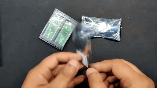

We also used PCBWAY's Giftshop for sourcing the Pico 2, DF Mini Player, and the SSD1306 Display.
PCBWAY gift shop is an online marketplace where you can get a variety of electronics modules and boards for their genuine price

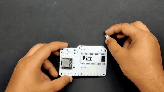

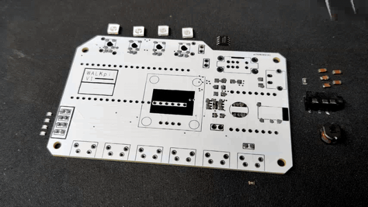

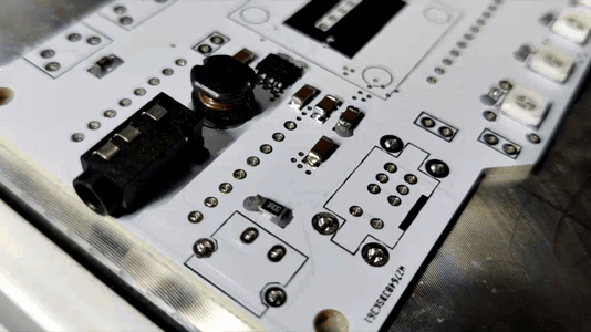

Step 4: PCB Assembly Process
  1. Applying solder paste to each component pad is the initial step in the circuit-building procedure. In this case, a solder paste dispenser synringe with 63/37 Sn/Pb solder paste is used.
  2. Next, we pick and place each component in its proper place.
  3. After that, we lift the circuit and place it on the reflow hotplate, which increases the PCB's temperature to the point where solder paste melts and all SMD components attach to their pads.
  4. Then, using a soldering iron, we solder all of the component leads in their proper locations after placing all of the through-hole components, such as the horizontal push buttons, Type C port, and CON2 JST connectors.

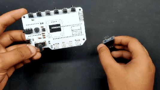

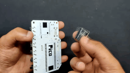

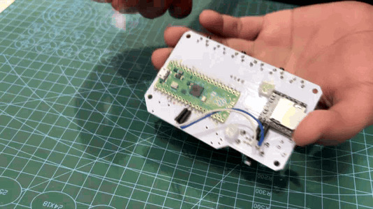

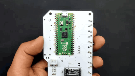

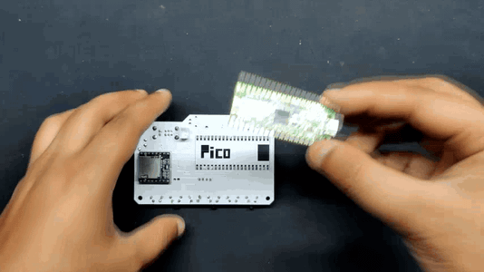

Step 5: Adding Modules Onto the Circuit (OLED, PICO, DF Player)
  1. We now set up every module, including the DF Mini Player, Pico 2, and SSD1306 Display, in its proper location. The SSD1306 Display is first added to the circuit from the top side, and its pad is subsequently soldered from the bottom side.
  2. Using a soldering iron, the terminals of the DF Mini Player are soldered from the top side of the board to the bottom side of the circuit.
  3. We also included two JST connectors, which will be used to connect the battery and speaker.
  4. In its place, we finally installed the Raspbery Pi Pico 2. We soldered the Pico directly onto the circuit using its castellated pads.
The circuit assembly is now complete.

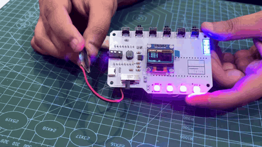

Step 7: Power Source
We are using a 14500 3.7V 600mAH Li-ion battery as the power supply, which is a smaller formfactored cell than the 18650 cells that are often utilized. In order to give the lithium battery both low-cut and high-cut functionality, we added a wire harness and a PCM.
  1. The JST connector on the wireharness links to the battery connector on the circuit.
  2. The device turns on when the Power button is pressed, and the four side LEDs that indicate the battery's current fuel level glow.
  3. The device can be turned off by double-pressing the Power Button.
  4. Because of its small capacity, the lithium cell can be charged using the Type C connector in a maximum of two hours using a 5V/2A charger.

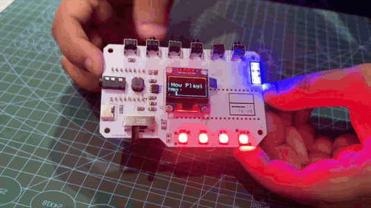

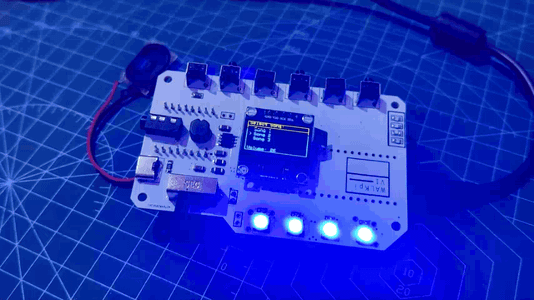

Step 8: Result
After the gadget has been set up and updated with the code and power, it turns on when we push the power button. The RGB LEDs illuminate red when the device first powers on, and a welcome message shows on the screen.
The song we wish to play is selected using the navigation buttons, and the song is picked using the select button. When the song has been selected and begins to play, we are presented with a Playing Now splash screen.
The slide switch allows the user to choose whether to connect earphones or play music on the built-in speaker.
RED RGB LEDs turn purple while the song is playing, then change color to blue and back to purple again. This pattern repeats itself.
