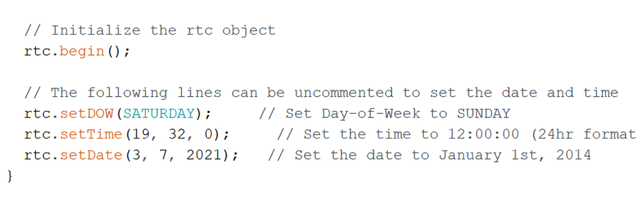

Step 1: Program DS3231 RTC to Set Time
To connect the DS3231 RTC module do it according to the picture or below:
VCC -> Arduino 5V
GND -> Arduino GND
SCL -> SCL or A5
SDA -> SDA or A4
As long as I know, there are dedicated SCL and SDA pins on the Arduino UNO and MEGA. There are also two other pins which are the32K and SQW ones but we will not use them as we get the full functionality through the I2C interface. Then uncomment (remove forward slash) the day, time, and date line and replace it with current information. Then without removing the connections again comment(put forward slash in front of code as in figure2 ) all the 3 lines and upload it again. Then to see if time is set open the serial monitor and the time will be displayed.
