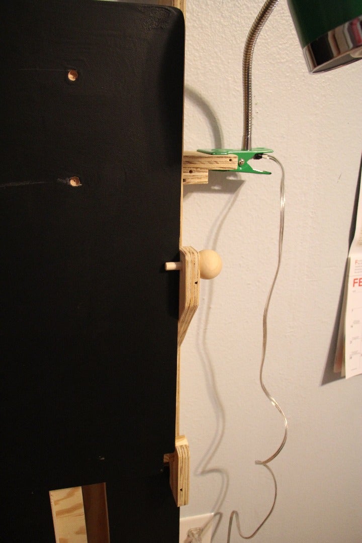

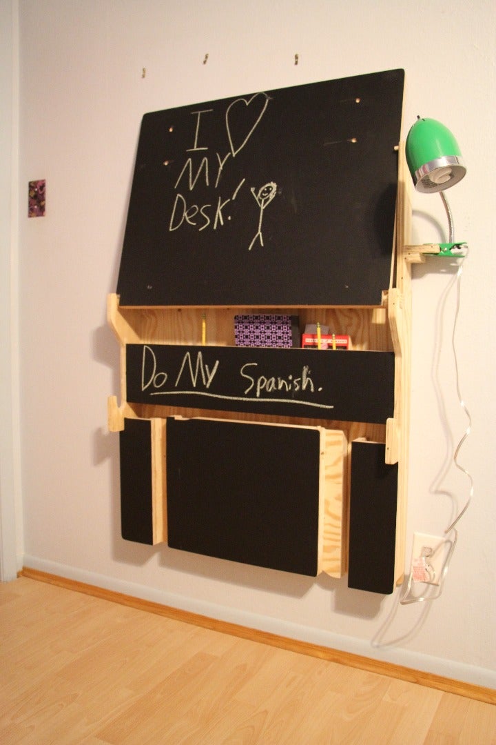

This is the wall desk in the stored position. The desk is the large 34" x 24" rectangle on top. It pivots on a 1 1/8" dowel rod attached along one edge with the dowel rod sitting in the frame that attaches to the wall. The wooden pin on the side locks the desk in the stored position. The pin comes out and can be used to store the desk top in an upper position when it is used as a drafting table as well. The legs fold in on piano hinges and the outer leg is the large rectangle underneath the desk. The other two rectangles on the sides allow for the legs to be inset a little.

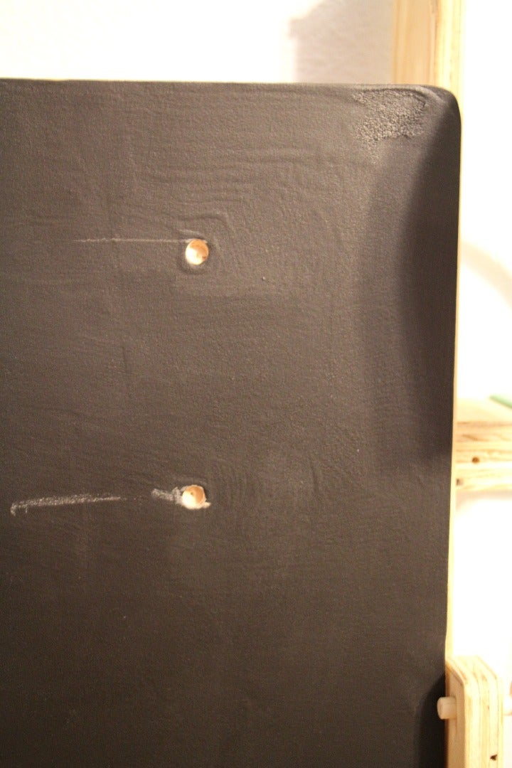

The desk is supported in both positions by two legs that fold out. I made the legs from two layers of 3/4" ply laminated together to make them extra sturdy and to avoid the plywood from warping over time. The bottom of the desk surface has fours holes that allow the pegs in the ends of the legs to lock in place. I also installed a magnet catch to keep the legs from falling open when the wall desk is stored.

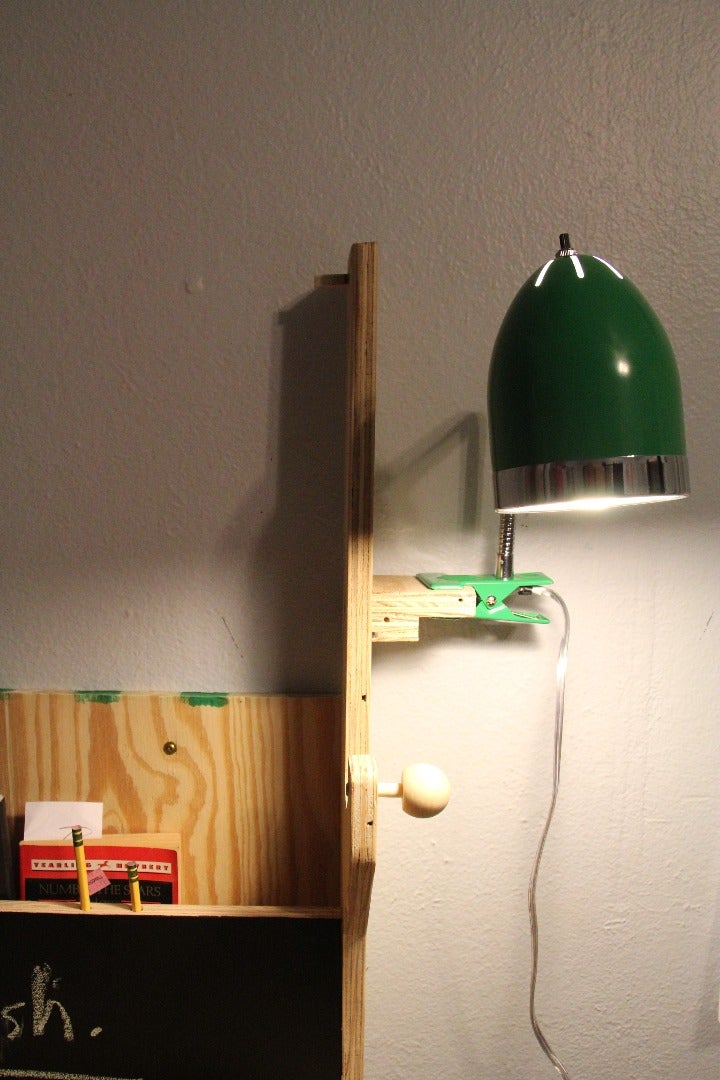

There is a book rack that is accessible when the wall desk is down. I drilled holes in the top edge of the panel that forms the front of the rack for pencil storage. I also added a bracket to the edge of the wall frame so a clamp light can be mounted.
