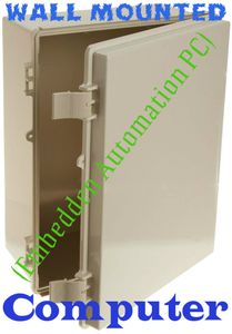

I always wanted my home automation pc to be wall mounted to free up space and also to keep it safe from physical impacts.
The first step is an appropriately sized plastic enclosure for a small motherboard. Here is what I have done.
Step 1: Mounting the Enclosure.
Using my hammer drill and rawl plugs I mounted the enclosure above the living room TV.

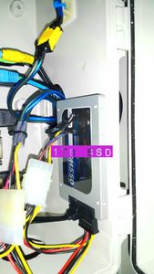

Step 5: Data Storage.
For internal data I used a ssd 1TB. To provide super fast backup of data to a redundant drive I use a 2.5inch external hot swap Bay which I stuck to the underside of the enclosure with double sided tape. The motherboard has usb3 but this has never lived up to its expectations. Sata3 gives awesome and guaranteed performance.
