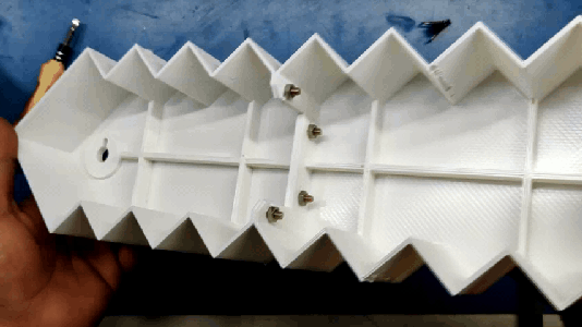

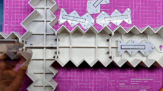

Using the shell command, we hollow out the entire model and then divide it into five sections.
Later, we further divide each section into two parts, which are the lid and the lower base part, which will house the LED board.
We constructed an inner wall inside the lid part so that both parts can be pushed fit together, allowing the lid to fit over the lower half without the need for glue or screws.
We designed parts such that we could mount two sections together with M3 bolts and nuts in order to join several parts together.

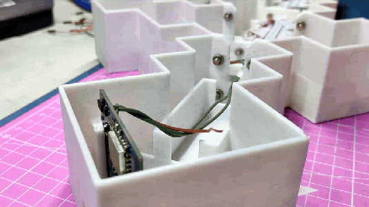

The circuit is housed in the grip portion of the model.

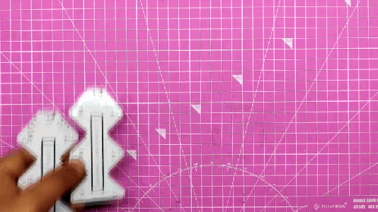

After the model was ready, we exported each of the five lower and five lid components into an STL file, then we used marble PLA for the lower part and transparent PLA for the lid to 3D print all of them.

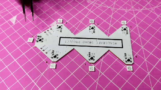

Let us explore the LED Board first.
The LED Board schematic shows seven WS2812B LEDs linked in parallel, which are intended for lighting the sword's top lid.
The led board was designed so that we could create a single design and use it for every part, eliminating the need to create a distinctive LED board for each one.
Two sides have been added to the schematic: the input side and the output side. The VCC and GND of both sides are connected in parallel. The only pins that are different are the DIN and DOUT pins, which are each connected to a different CON2 pad.
To stabilize the LED, we use 100nF capacitors, each connected to a single LED, so a total of seven capacitors were used.
The PCB outline is created using model dimensions that are extracted from the Fusion360 model into a DWG file, which is then imported into our PCB Cad software.

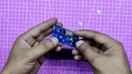

The second board was the ESP12F board.
As the name suggests, the ESP12F Board is a minimal breakout version of the ESP12F Model used in boards like the NODEMCU or other ESP8266 products.
In the schematic, we have added an additional AMS1117 3V version, which steps down the voltage coming from the input side to a stable 3V for ESP12F to function.

Step 4: LED BOARD ASSEMBLY
  • Using a solder paste dispensing needle, we first add solder paste to each component pad, one by one. We're using standard 37/63 solder paste here.
  • Next, we pick and place all the SMD components in their places on the PCB using an ESD tweezer.

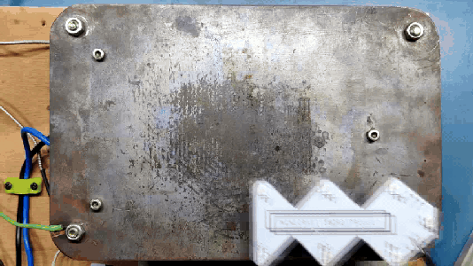

  • With extreme caution, we lifted the complete circuit board and placed it on the SMT hotplate, which increases the PCB's temperature to the point at which the solder paste melts and all of the components are connected to their pads.
We are preparing a total of five LED boards to be used in the sword assembly.

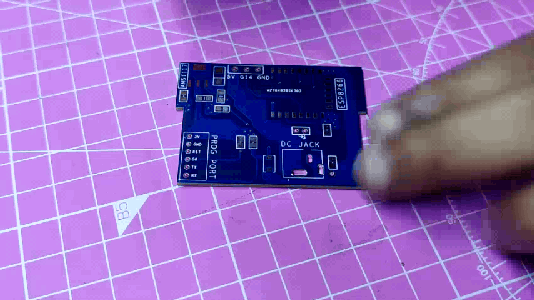

Step 5: CIRCUIT ASSEMBLY
  • After preparing the LED board, we prepare the main circuit board, which starts by adding solder paste to each component pad one by one.
  • Next, we all place the SMD components in their positions using a tweezer.
  • We then pick the whole circuit and place it on the SMT Reflow hotplate for the reflow process, which heats the PCB up to the solder paste melting temperature, reflowing all the SMD components with the PCB.

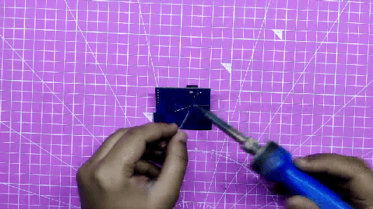

  • Next, we add the remaining THT components to the PCB, which are the DC barrel jack and the indicator LED.
  • We then soldered their pads using a soldering iron, and the circuit PCB is now complete.

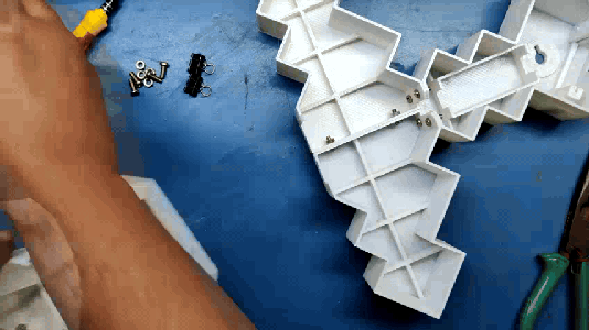

The Sword's Blade part is assembled first by applying super glue on one side of it. Next, in order to maintain a firm grasp between the two components, we attach the second part to the first one by using paper clips to join the two.
After letting the superglue cure for half an hour, we fastened four M3 nuts and bolts to the holes on each component. This kept the two pieces attached.
Following that, the cross-guard assembly and the handle part are attached to one another using superglue. Paper clips are then used to firmly hold the two pieces together, and four M3 nuts and bolts are used to fasten both assemblies together.
Using the same procedure, we were able to finally link the sword's blade assembly to the cross-guard handle assembly.

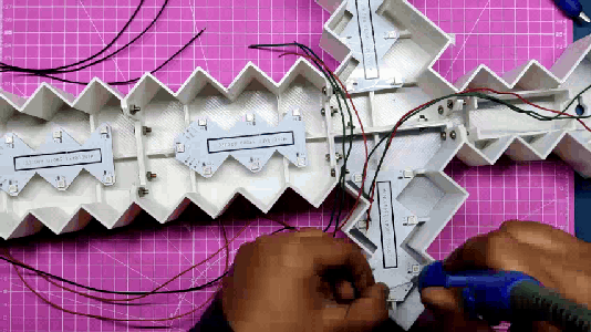

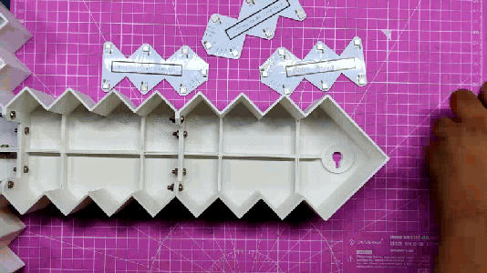

Step 8: Adding LED Board Inside Base
  • After assembling all parts of the sword together, we start the LED board placement process, which starts by adding the LED board inside the sword blade section first.
  • We use hot glue to secure the LED board in its place.
  • We add the LED board to all sections of the sword except the grip section.

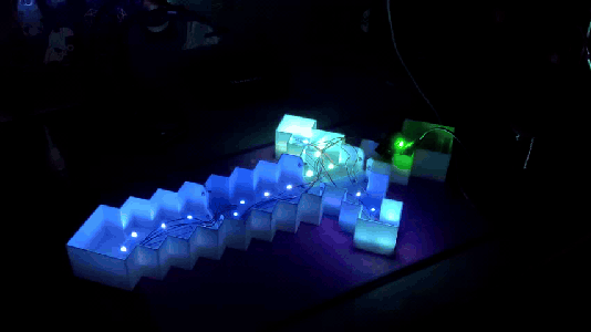

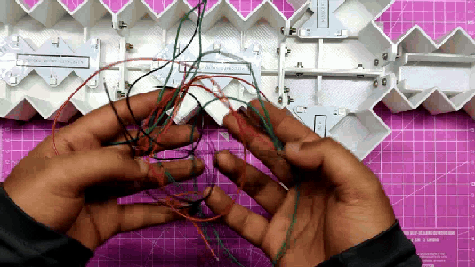

Step 9: Wiring Process

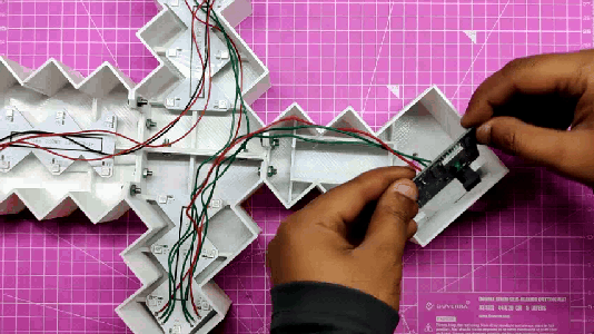

  • We begin by connecting all of the LED boards' VCC and GND in parallel with one another, as specified in the wiring schematic.
  • The first LED board's Dout is then connected to the second LED board's Din, the second LED board's Dout is connected to the third LED board's Din, and finally, the third LED board's Dout is connected to the fourth LED board's Din.
  • The Din of the first LED board is attached to the GPIO14 pin, and the VCC and GND are connected to the circuit's VCC and GND.
The wiring has been completed.

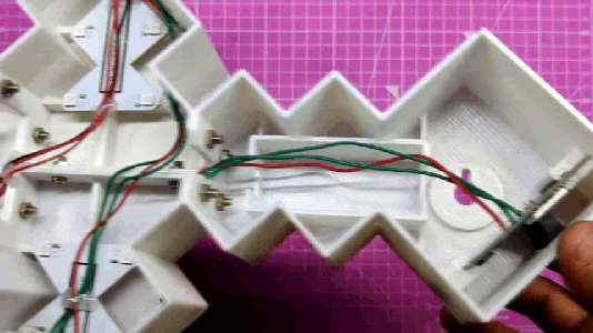

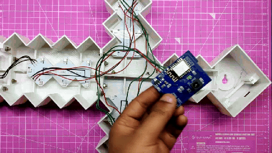

In the final assembly stage, we first slide down the main circuit in its place, modeled inside the lower grip part.
The bundle of wires inside the body is next secured using hot glue; this procedure is done for wire management.
We take the lid portion and place it on top of the assembled sword, Two parts fit perfectly because there is less tolerance between the inner walls of the two parts, this is also called pressure fit.
One by one, we set each lid in its proper place, and the assembly is now finished.

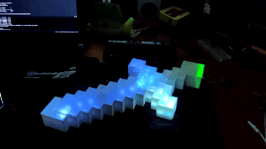

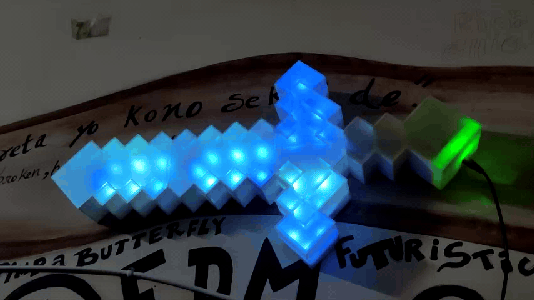

Step 11: RESULT
This is the end result of my little build: a functioning, illuminated, life-size Minecraft sword that I built from scratch using 3D printed parts and custom PCBs.
We are using a barrel DC Jack to USB Port cable that is connected to a 5V 2A power source to power this system.
By using two nails, we were able to mount this setup on a wall thanks to the keyholes made during the model design process.
The best thing about this project was how the parts were printed with a small 3D printer and divided into smaller printable bits so that anyone with a small printer could easily build it.
Overall, this project is complete and needs no further revisions.
