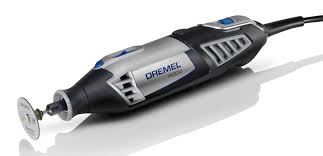

- My boots had a connection clip at the top of the heel back plate. I didn't take any prisoners, powered up my dremel and cut the clip into shreds. Kinda fun. Remember to wear your safety glasses.
- As I mentioned, the boots were rather old, so they still had a wire closing mechanism. I removed the wire loop without exertion of any unnecessary force.
- Two big rivets built the hinge mechanism of the heel back plate. Trying not to cut into the boot material underneath I severed the back hinge plates close to the rivets using the dremel once again.

- The heel section was definitely in the way for inserting a power drill into the boot. More happy dremeling was executed and the heel removed while leaving the sole section intact.

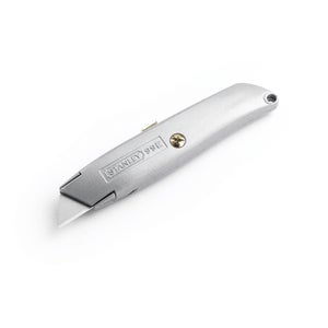

- The plastic of the heel was rather thick and some melted plastic shreds hang on along the cut lines. I deburred everything by dragging a regular carpet knife along the edges.
