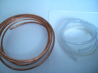

Plastic/vinyl water tubing: Measure the waterblock and pump diameter and purchase the aproppriate size and lenght.
Water servoir: (you can buy one , or make your own as i did ) Ebay sellers use plexiglass boxes, but i really prefered an empty antifreeze car liquid bottle.
Copper Tubing Radiator: ( Is used to make the radiator. get as much as you decide is needed for your pc performance. You can buy the radiator too if you prefer a better looking result ) The radiator is basically tha part that is going to exchange heat between the water and the enviroment. Bigger radiator means more efficient heat dumping.

Using a cylindrical object, i started making spirals with the copper tubing around it. The idea is to form a coil of medium density. Keep it compact but with enought space between the coils for the air to move freely.

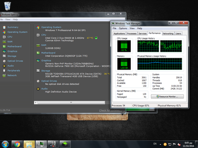

Eventually everything unraveled as planned. No leaks no surprises. Yet anyone should be aware that such a build will not be troublefree. Minor fixes or part replacements will be needed in the long run, but im ok with this fact.
In other news, as the screenshots state, our rig has nothing to be jealous of from commercially sold pricey systems. The shots are instantly after booting and after 4 hourds of internet browsing and music recording. I actually find it impressive that even with heavy use the temperature could not rise above 55 degrees celsius.
