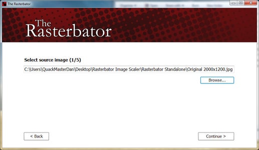

1. Go to http://homokaasu.org/rasterbator/ and either download the standalone application, or use the online-only version which has file-size and image resolution limits.
2. Open Rasterbator stand-alone or the online-version, and you will be asked for your source image. Select your JPG image.

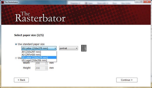

3. If you live in the United States, select "Standard Paper Size" US Letter (216x279mm). I suggest portait mode. Europe more often uses A4 sized paper.

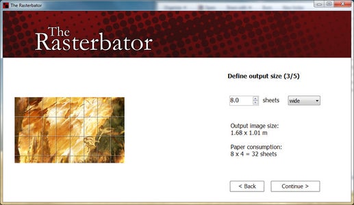

4. Select the size of your image, a larger poster entails a higher cost and more work, though an immense poster can be very rewarding.
5. I suggest using a dot size of 3-4mm for anything fifteen feet and under, as this allows for more fine resolution and easier lining up of pages than the default size of 10mm. Generally, larger images use larger size dots, smaller images use smaller dots. Select Black (and White), Monochrome (Custom Color), or Full-color (Multi-color) by your preference.
