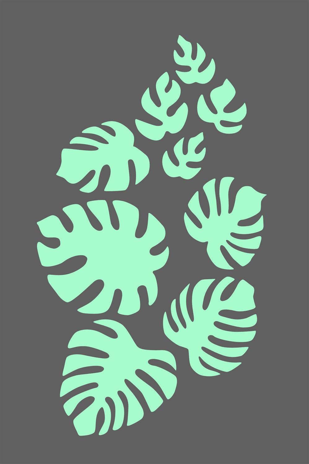

I've collected plenty of monstera leaf reference images in the past to create this Crazy Plant Pal and Crazy Plant Lady art. But that was a drawing and now I have to create something that I can laser cut to be strong enough to hold some of the heavier necklaces I have.
Also, I can't just draw one leaf and reposition it. This is going to be an art piece so variety (just like in the real plant) is necessary.
And throughout the years I've learned that going outside the box (yeah, ugh, I know) creates a more interesting composition.
So the first thing I need to do is draw the box (or rectangle in this case). I'm not entirely sure how big this piece will need to be. It all depends on how many leaves I need to draw to get the right number of lobes that are upright enough to hold the jewelry I have and yet to have. My future jewelry spots might depend on how big the piece needs to be for my present jewelry. If it starts to be too big, I will turn it into a triptych.
It's important to note that the biggest size I can cut on my laser cutter is 16" x 11.5" (I can cut deeper but the wood I have is 18" x 12"). I've tried cutting wider than 16" but there were issues, so I try to remain at 16" or less. If I need the art to be wider or taller, I usually cut everything in pieces and puzzle them together.
So, I created a rectangle 11.5" wide by 16" deep. I wanted a half-inch border so I drew another rectangle to be 10.5" by 15" and centered those to create my frame.
Then I pulled a bunch of reference images of monstera leaves (large and small) onto the artboard and started tracing them. I wanted a good variety so I drew a lot of them. I only drew the leaves because I planned to draw the vines separately on the rectangle and place the leaves where I needed them inside the actual art.

  1. I realized as I was tracing the images that the lobes might be too big to place rings over. The width of the inner part of my rings and the jump rings on my sun catchers is a half inch. The width inside the cuff of my ear cuff is 5/16". But on the images of the vining monsteras, I noticed these little stems sticking out where I assume a branch is trying to develop. So I planned to add several of those to help.
  2. Another thing I thought of during this process is that I would need to go back and make sure that the lobes are spaced far enough apart for me to drape things over them or even put my fingers between them if needed. Some of my necklaces and all of my bracelets have lots of beads so I'm not just trying to provide space for a thin chain for most of these.
  3. On a real monstera plant, the bigger the leaves, the more downward they turn probably because they are heavier. I could still use downward facing leaves since they still have lobes at the top I can drape a necklace or bracelet over. But I may take artistic license here and go against nature in order to make sure they can be useful for my purposes.
  4. After I drew eight monstera leaves they all started to look the same even though I was tracing different plants. So I decided to stop there and just make minor adjustments with the ones I had to create the variety I need.
  5. I counted how many necklaces I might be able to hang (just the necklaces) from those eight leaves and decided it might be 8-10. That's when I decided this definitely needs to be a triptych. For now I'm only going to cut one to test the design and the look.
