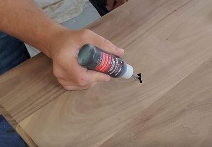

With the base laid on the top I marked all the mounting holes and the skirt location so I could see where the inductive charger could fit. I then marked that location and drilled a small hole at the center of the charger to mark the location on the top. Then I flipped the top over and taped the charging symbol I printed out over the hole I just drilled. Then I carved out the symbol with a sharp box cutter and squared off the edged with a sharp chisel. Then I filled with black CA glue and sanded flush with the wood surface.

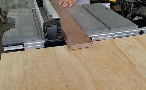

I wanted my skirt to be beveled, so I cut a 30 degree bevel cut on each long edge. The bevel cuts should be parallel to each other as shown. Then I made 30 degree nailing blocks to attach the skirt to and glued them to the top with wood and CA glue. Next I cut the skirt sections to length with 45 degree miter cuts in the corners using my crown molding jig.
