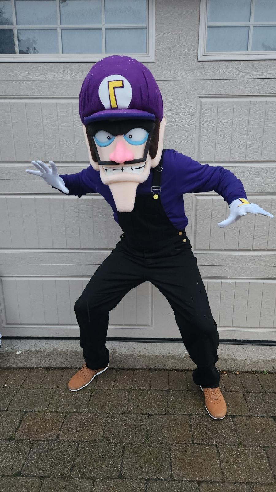

I was hoping to find a lighter brown for the hair, but this dog bed I found at the dollar store was the perfect amount of material to make the side burns and hair at the back of the mask. Still not sure why Waluigi has a black mustache and eyebrows and brown hair. Anyway, I cut two side burn shapes in foam and used more spray adhesive to attach the doge bed material. I lucked out and found a large piece of purple felt at the thrift store. I bought it in case the purple shirt didn't work out for covering the hat. The felt was much better at hiding the imperfections in the carved foam shape that I made for the hat. It was a bit fussy wrapping the round shape with the felt, but I cut the basic shape and stuffed the edges up and under the foam shape. You can see on the back side of the mask, that I cut a groove in the foam to receive the felt. This also worked a place to stuff the hair into. I didn't even need much glue to hold it all together. I used the hot glue gun to glue on the ears and the mask was complete except for the upside down 'L' that adorns his cap. I neglected to take pictures of this step, but it's basically the same as how I make the gloves in the next step.
Step 9: Gloves
I had a bit of trouble tracking down some plain white gloves, and when I did, I had to buy four pairs to get two that fit right. I used some of the felt from before and cutout the 'L' shapes. I attached the layers with some double-sided tape. The last picture shows the yellow buttons I glued to the overalls that I bought. Overall this costume build went pretty smoothly and I happy that I was able to pull it off having only started on the 12th of October.

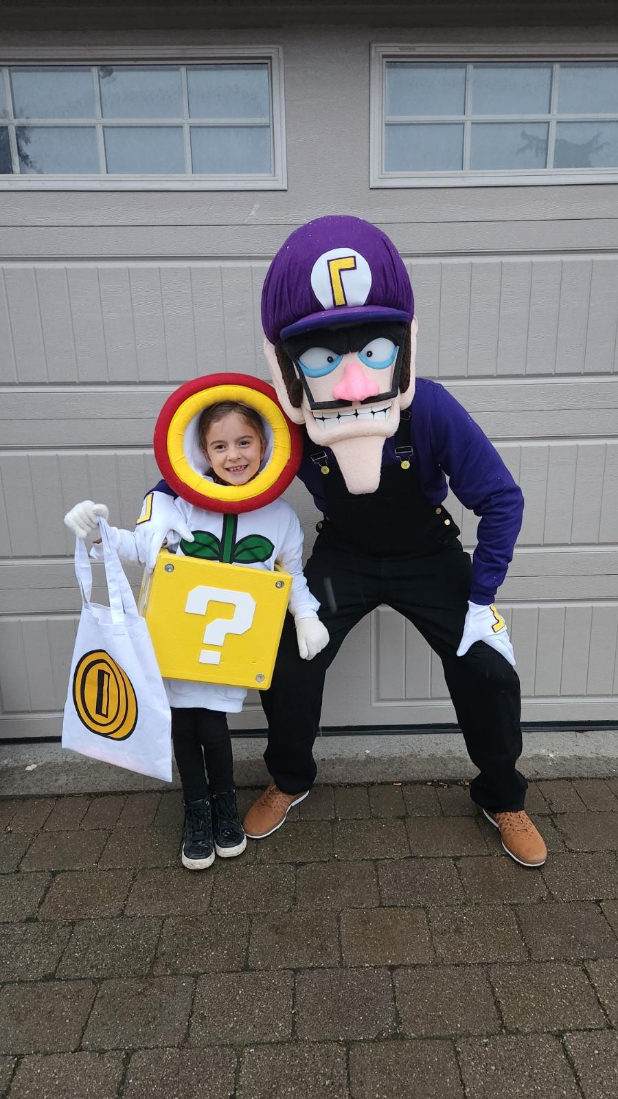

Here I am posing with my 7 year old daughter Alex who is wearing her 'Fire Flower coming out of a Question Box' costume. You can check it out in my other instructables. We had an awesome time planning and building our costumes this year! The last picture is Waluigi on the loose at the High School where I teach. I'm happy to report that while I could barely see out of my costume. I survived the day at work and the evening of trick-or-treating. We're already thinking of ideas for next year. Stay tuned.....
