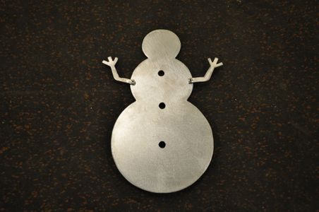

Step 1: Select Your Material.
Choose and purchase your material by type and thickness. For this snowman, 1/8" Aluminum was used.

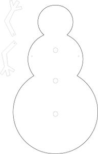

Step 2: Transfer the Design
Now you need to transfer the design onto your metal.
You can print out the paper template, or make one yourself.
If you are using a paper template, cut along the lines and use a glue stick to adhere the paper shape to the metal.
You can also use the acrylic template provided at NextFab to trace out the shape.
Use an extra-fine tip sharpie or a metal scribe to follow the contours.
You can copy the buttons over now, or later.
Be sure to outline the arms!
Step 3: Cutting Out Your Snowman
Now you can cut out your shape!
Using a band saw, select the proper speed based on your material type and thickness.
Cut out as much of the arms and hands as you can now, before you separate them from the rest of the body.

Step 5: Mark Where to Attach the Arms and Layout the Buttons
Locate and mark where you would like to attach his arms to the body, marking both arms and the body.
Use a center punch to provide an area for the drill bit to center on.
Do the same process for preparing to drill out his buttons.
Step 6: Drill the Holes
Drill a .128" diameter hole in the body and arms on your center punched marks.
If you want to make the holes for his buttons, use a 3/8" drill bit.

Step 8: Attach the Arms
You will need a (2) 1/8" Aluminum rivets and a Rivet Gun
Insert one rivet through the hole in the arm and insert the remaining length of the rivet into the hole on the body.
Press the pieces together firmly, ensuring there is no gap between the material.
Squeeze the handle to lock the rivet.
The arm should now be attached to the body. Repeat the same process for the other side.
Step 9: Enjoy Your Everlasting Snowman!
