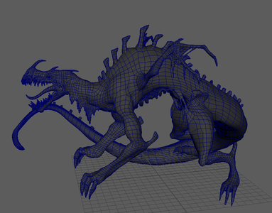

Once you have finish your high-poly sculpt of your character, it is time to retopolize so it can be textured and animated! This is the most time-consuming and tedious step so make sure to have some music playing in the background so your mind does not go numb.
Firstly begin by importing your high-poly sculpt into your 3D program of choice, I personally used Autodesk Maya as their retopology tools are unmatched.
There are many different workflows to retopology but almost all workflows utilize Maya's Quad Draw Tool.
To start off, you must first make your high-poly a Live Surface so you can begin placing faces on top. Then by using quad draw, carefully place each face while keeping in mind proper edge flow and topology knowledge. After many many hours of tedious work, the lowpoly model is finally complete!
Important Things to Keep in Mind:
  1. Quad,Quad,Quads: Try your best to make all of your mesh have four-sided faces. Tris (3 Sides) are sometimes acceptable but NGons (5+ Sides) are a no no.
  2. Patience: Many people often rush this step however that will affect all of the pipeline down the road. This step is crucial down the road for Texturing and Rigging so try your best
  3. Edge Flow: Edge flow is extremely important in places where our bodies are bent a lot, such as the armpit, elbow, fingers. It is super important to have the knowledge of where to put extra loops and how to have that clean deformation when it is eventually animated.

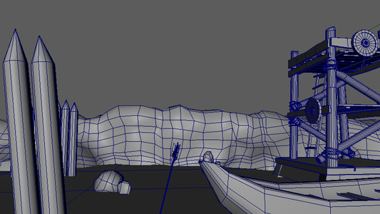

Step 7: Environment : Planning & Modeling
Sadly, we cannot go straight into animation as we do not have a set to place our character. We'll first have to repeat all of the steps we did for our character but now with our environment. I prefer creating the environment after the character is done so I can get a sense of what vibes my character gives off and what kind of environment would best complement my character's atmosphere.
First, is finding reference, sketches, etc. You could either build your own environment or reference one. For this project I made my own sketch of what I thought would be a cool environment for my dragon.
Second, is modeling. Make all of the props in your environment and the general landscape. I repeated steps 2 and 3 for the more organic shapes such as the mountain and rocks. I sculpted a rocky landscape which I then took into Maya to retopolize.

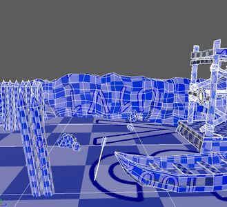

Step 8: Environment : UV and Texturing
Now its time to repeat steps 4 and 5 but for our environment.
Cut and UV all of your objects and arrange the UVs in a UDIM format for more detail. Import to your Texturing Software and bake the high-poly mesh to the low-poly version.
