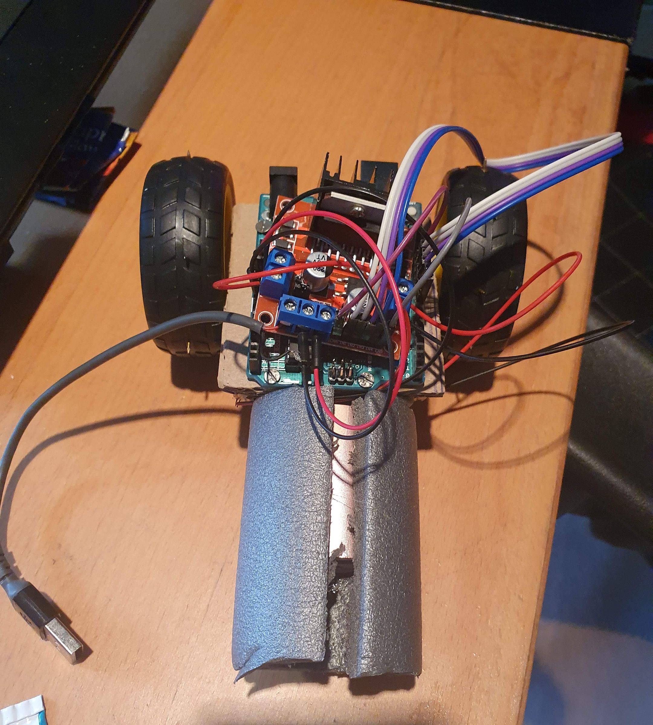

Step 1: Arduino Connections
Arduino to motor driver connection
First connect the motor driver to the Arduino, do this by connecting the 4 pins next to the 3 blue ports that read in1 to in4, I connected them to pin 9 to pin 6 (as shown in the code and pictures).
Servo's to motor driver connection
Then connect the 2 servo's to the motor driver module by connecting the wires from the servo's into the 2 blue ports on the side of the motor driver.
You should test out the servo's to check if they are both spinning in the right direction, otherwise they will push/pull against each other. If that is the case just simply switch one of the servo's connection.
Power supply to Arduino and motor driver connection
And at last connect the power supply to the motor driver module and Arduino. I connected the 2 6v battery housing together with one end each, leaving one red wire from one and one black wire from the other housing.
Connect the black wire in the ground port on the motor driver together with the pin in the ground from the Arduino.
Then connect the red wire in the 12v port on the motor driver with the Arduino wire going into the Vin port next to the ground (not the 5v port!)
