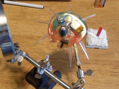

Step 1: Circuit
First, you may be wondering what this is. This is my custom made miniature for table-top a tabletop wargame called Warhammer. The guy at the top is a regular model from the maker of the game (Gamesworkshop), but the disk and base are all mine. The build for him is the subject of another instructable, so I won't go into that here.
Circuit
The basic idea here was to take a small, 8 pin micro to control 3 LEDs and a motor, with as small a supply as possible.
Use of the "helping-hands", as always, is a good idea. These things have two clips to hold whatever you are working on.
No schematic was needed, as the impementation is very simple;
An 8 pin micro (Microchip PIC) with 3 output pins going straight to LEDs, and 2 output pins going to 1 motor.
The LED's used are a Blue, White and Red surface mount type.
The Motor used was ripped from a broken indoor micro helecopter.
The battery (small Lipo) was also ripped from the heli, but i already plan to use another source for more power.
A switch was added for On/Off.

Step 2: Code
The code for the PIC was made to optimize battery life and use many random "events".
In order to have the battery last as long as possible, the circuit had to use the least amount of power I could figure, while keeping the idea alive. So, I decided to reduce the initial activity to an average of 1 LED flash or motor move every 6 seconds.
The code has 12 random "activities" , ranging from 1 LED turning on, the motor turning on for different time periods or directions, to a random wait state. Events vary from 3seconds apart to more than 40 seconds apart, based on the random event generated.

Step 3: Parts
This picture shows how small I had to get the components to fit under this guy.
1 8-pin Microchip (PIC)
3 SMT LED's (Blue, Red, White)
1 Motor from an indoor micro heli.
1 LIPO battery from same heli.
1 power switch
1 2.5mm wooden dowel (2" long)
2 1mm rare earth magnets
1 power switch
