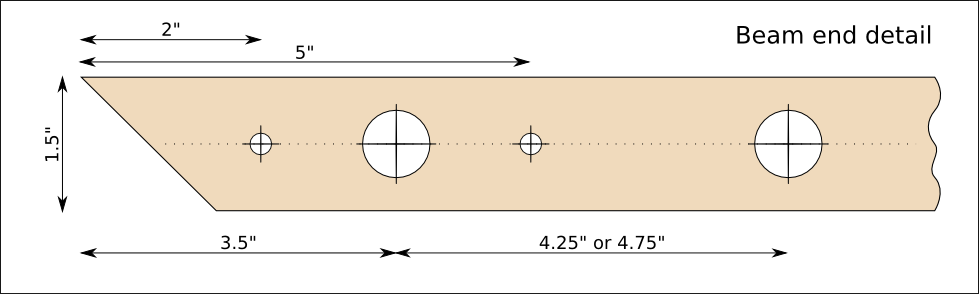

The wooden beams are made in two pairs -- one set for the meter side, one for the yard side. I used 1.5" x 3/4" stock for both. The yard pair is 36.75" long and the meter pair is 40.1". I cut mine a bit short, since I wanted to make sure they fit. I didn't mind a bit of a gap, as precision woodworking is not one of my skills. The ends are mitered at 45 degrees, and there are 2 1/4" holes at each end for the corner plate bolts. See the attached image for complete dimensions. The bolt holes are the same on both the yard and the meter beams, which allows the corner plates to be symmetrical and interchangeable.
Each beam has 8 pegs on it, though that's an arbitrary number. I just figured we might as well put a bunch on. Better too many than too few! Each peg is a 6" section of 3/4" dowel, with one end sanded down to form a nicely rounded edge. They are spaced apart by 4.25" on the yard beams and 4.75" on the meter beams.
