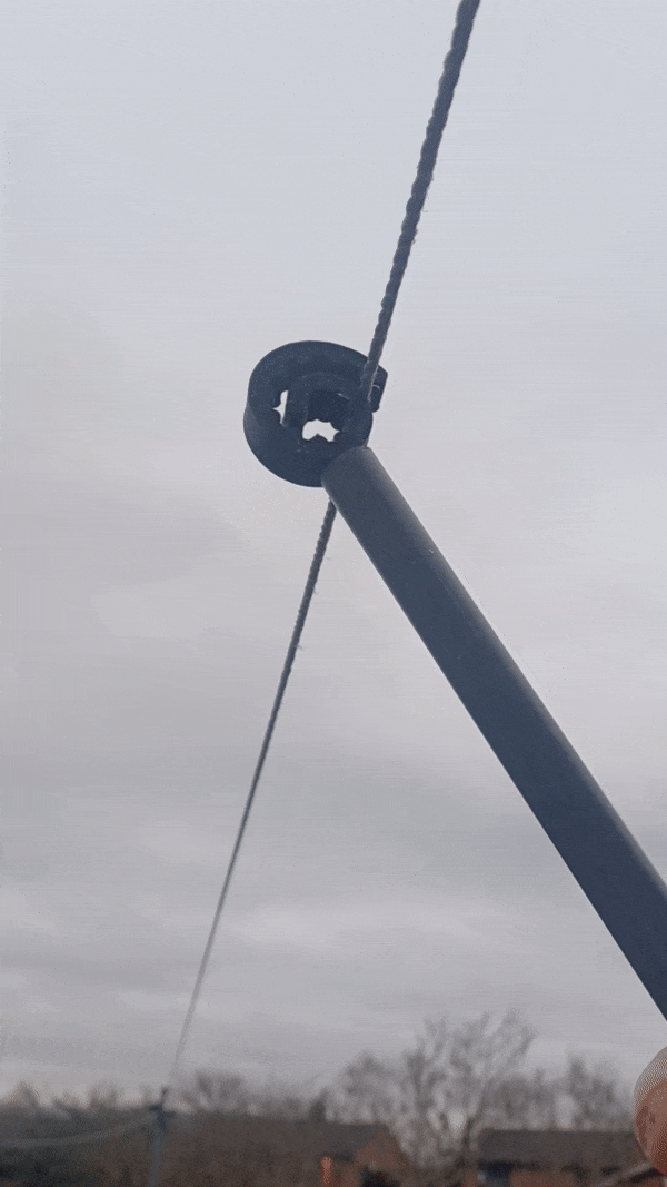

The following project was created due to the necessity to make a repair and at the same time save money.
Created with TinkerCAD Block Code and 3D printed.
The broken prop* head to be replaced is small in comparison to the over size of the item being repaired and after an internet search which drew a blank for a replacement, it seemed a waste to consign the metal pole which made up the bulk of the prop to the scrap when the pole was perfectly fine.
*A prop is a support and in this context is used to support a washing line.

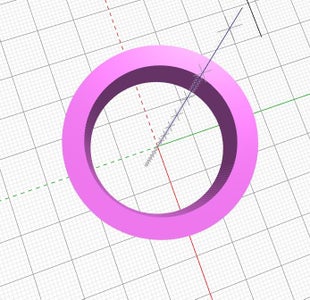

If we consider a circle and how it can be generated in code.
Any point on the circumference of the circle can be referenced from the centre using Pythagorus theroem.
Where: Radius = Hypotenuse, Base = X and Altitude = Y
Radius = sqrt(X^2 + Y^2)
Therefore, all points are equidistant from the centre, this distance being the radius.
However, in order to generate a circle the values for X and Y are required.
From a trigonometric perspective:
X/Radius = Cosine(angle) and Y/Radius = Sine(angle)
With one revolution equal to 2Pi radians or 360 degrees, sin(angle) or cosine(angle) will range from -1 to +1.
Knowing the Radius and the angle, X and Y can be calculated.
Circle
Applying this in an OpenSCAD code example:
for (i = [0 : abs(1) : 360]) {
 translate([(sin(i) * 10), (cos(i) * 10), 0]){
  cylinder(r1=1, r2=1, h=1, center=false);
This executes a loop where the angle starts at 0 and ends at 360 with 1 degree increments.
The point on the circumference is defined by the function of the angle multiplied by the radius = 10.
At the point is plotted a vertical cylinder (Radius =1 & Height = 1), these overlap creating a solid perimeter.

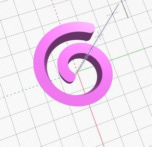

Spiral
This is all well for a circle but we need to create a spiral.
This is created in a similar manner to a circle however the perimeter does not meet, starting from the centre with progressively larger twists gradually increasing the radius.
 translate([(sin(i) * (i / 32)), (cos(i) * (i / 32), 0]){
The main difference between this code and the previous code for the circle is in the multiplier. Rather than a fixed value equal to the radius there is now a value equal to a fraction of the radius. (i/n) where n = 32. Therefore, the radius gradually changes from 0 to 11.5
This gives us the basics of the spiral but we may wish to make adjustments with regards to the size (i/n), number of spiral loops (i), the rate the spiral moves out from the centre (n), the eccentricity of the circle due to different values of (n) applied to the X and Y co-ordinates.

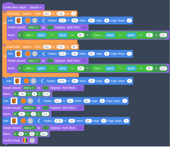

Step 6: Coding
The code for the final object is created using TinkerCAD Block Code.
Spiral
The first part of the code creates the basic spiral that forms the hook.
This is made using a cylinder with radius 2.5 mm and 13 mm high, which is within a loop.
Start and end points from the basic spiral adjusted to create alignment with the pole for easier engagement.
Step increment of 3 rather than 1 due to primitives limitation of 200, this creates a ridged textured on the hook due to the effect of the overlap of the cylinders that make up the spiral.
This creates a total of 170 cylinders overlapping their predecessors to form a continuous spiral of 1.5 loops.
The loop is eccentric in nature to create a slightly less regular sitting point for the line. This is expressed in the multiplier with values of (i/32) and (i/35) for the two co-ordinates.
However, the inner curved surface of the spiral which is horizontal to the line enables the line to move easily around this curve as the pole sways back and forth and therefore possibly work loose.
In order to reduce the likelyhood of this event occuring, ridges are placed at intervals on the inner curved surface to provide additional engagement with the line.
These ridges are also made of cylinders with radius 2.3 mm and 13 mm high also in a loop, creating 16 ridges.
Holes are created on the lower part of the spiral to enable an M4 cheese head Allen bolt to sit at or just below the main inner curve.
Directly in line with this and passing up and through the two spiral arms above, 2 x 4 mm holes are made.
The holes allow an Allen key to pass through and into the Allen bolt head to fix the head in place.

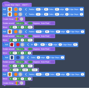

Peg and wedge nut
Attached to the spiral at the lower end is a cylindrical peg with cylindrical wedge nut.
Formed by splitting a cylinder of radius 6.5 mm and 30 mm long with a rectangle of width 3mm placed at an angle of 30 degrees creating two inclinded surfaces and a separate wedge nut.
The hole in the wedge nut is designed to be slightly smaller than the diameter of the bolt such that is self taps the thread as tightened.
However, for extra security, provision is made to fix an M4 hex nut in a recess in the bottom of the wedge nut.

With washing on the line, hook the open end of the head over the washing line and move it around the spiral gap toward the centre of the line to rest on the upper curve of the final spiral.
Push the prop up and plant the pole into the ground.
