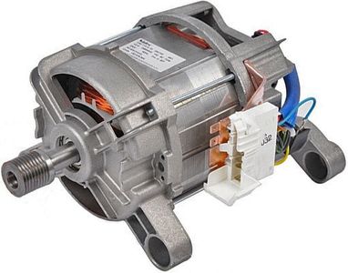

Step 1: Universal Motor
The universal motor is so named because it is a type of electric motor that can operate on AC or DC power. It is a commutated series-wound motor where the stator's field coils are connected in series with the rotor windings through a commutator.
It is often referred to as an AC series motor. The universal motor is very similar to a DC series motor in construction, but is modified slightly to allow the motor to operate properly on AC power. This type of electric motor can operate well on AC because the current in both the field coils and the armature (and the resultant magnetic fields) will alternate (reverse polarity) synchronously with the supply. Hence the resulting mechanical force will occur in a consistent direction of rotation, independent of the direction of applied voltage, but determined by the commutator and polarity of the field coils.
Universal motors have high starting torque, can run at high speed, and are lightweight and compact. They are commonly used in portable power tools and equipment, as well as many household appliances. They're also relatively easy to control, electromechanically using tapped coils, or electronically. However, the commutator has brushes that wear, so they are much less often used for equipment that is in continuous use. In addition, partly because of the commutator, universal motors are typically very noisy, both acoustically and electromagnetically.

there i have some videos related to the washing machine motor things that i have discovered, tests trial and error but that is the way we learn best.For the today tutorial, i will show how to control the speed of your washing machine and you can use it after for your project i saw people making disk sander, belt sander, wood splitter, propellers, go kart, electric bike from this motor so it's very useful cheap and reliable.

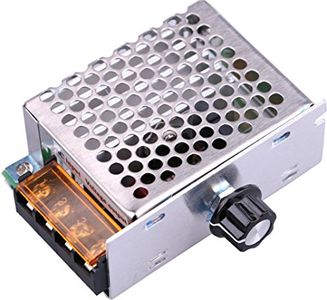

First is a dedicated ac voltage motor controller
that you can find online and is made just for that to lower the voltage of the mains according to the pot minimum is 50v this method is very easy the device has input terminals and output.In the input, you connect the main lines and output your washing machine motor or another load.
