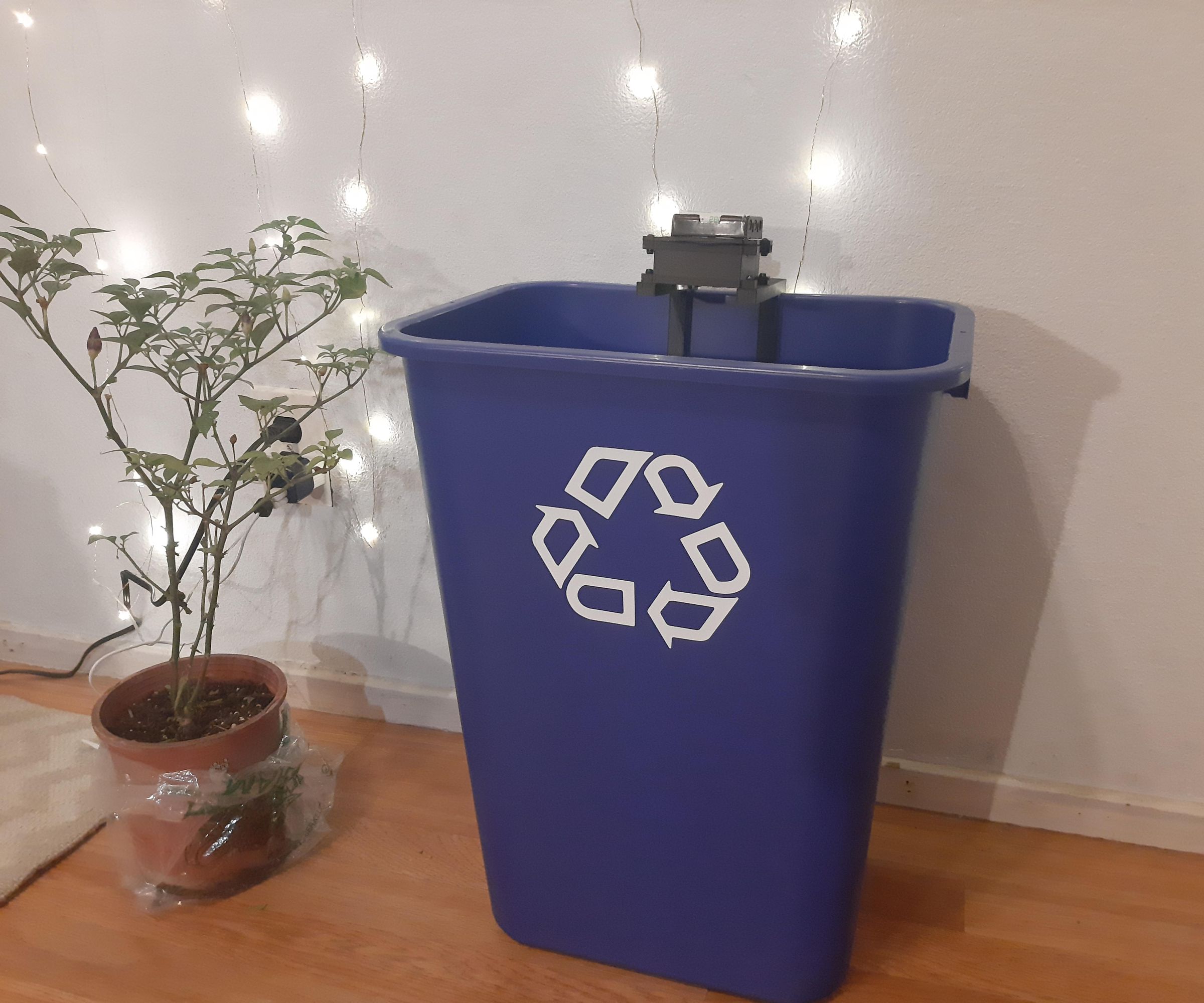

This project is called Waste Watcher, a project from ZotBins, which is an IoT based sensor module to help keep track of waste data metrics with real-time bin fullness data and waste images. This is intended to help quantify and promote actionable solutions to reduce waste 🌱.

  1. Before starting make sure that your bin is compatible with the case. If not, you may need to modify or create different handles. (please share them if you do! 🙂)

  4. Screw on the lid with the USB cable coming out of the rectangular hole on top
