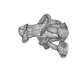

Next, Freddy was scanned. Then he was modified (hole in interior) to accept a Spark controller. Finally, he was 3d printed.

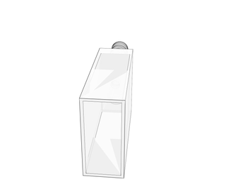

Now, we finish our 3d printing with an electroncs/moisture leg holder and a stake to hold the plant watering hose.

Push all these wires and the Spark module into the electronics container.

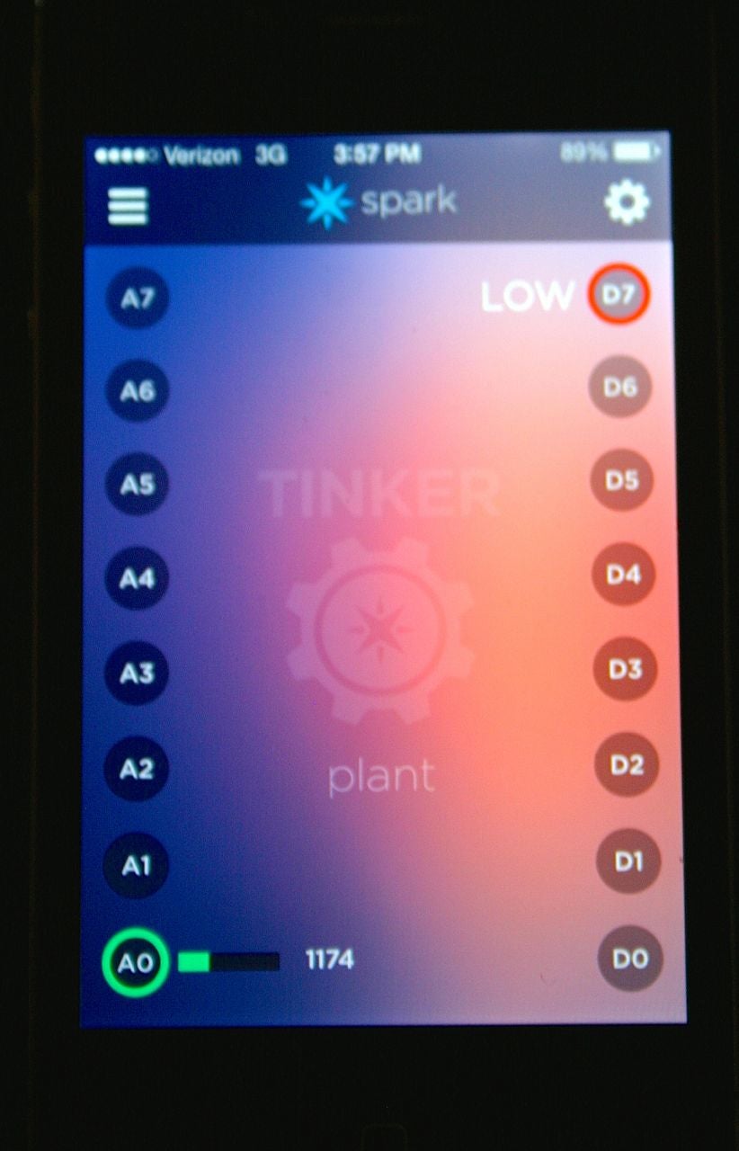

Set up the Spark module--it's really easy.
Load the Spark app on your smartphone. Power up the Spark module and your phone near your wireless router. Make sure that your phone is operating on wifi.
Open the Spark app. It will ask for the wifi password. The Spark app will find the Spark module (the module will be flashing all kinds of colors to indicate that it is ready). Name the Spark module whatever you want (I called this one "Plant").
Now, using the Spark Tinker program (default), choose "digital write" for pin D7. When you toggle pin D7 on and off, it will cause your pump to turn on and off.
Using the Spark app, choose "Analog Read" for pin A0. If the number is high (2500), then your plant is dry. If low (around 1100), the plant is moist.

Open the Spark app (from anywhere in the world) and choose the "Plant" module. Perform an "Analog Read" of pin A0 and you will know the plant's moisture status.
If the plant needs water, do a "Digital Write" on pin D7. When "on," the pump runs and the plant is being watered.
