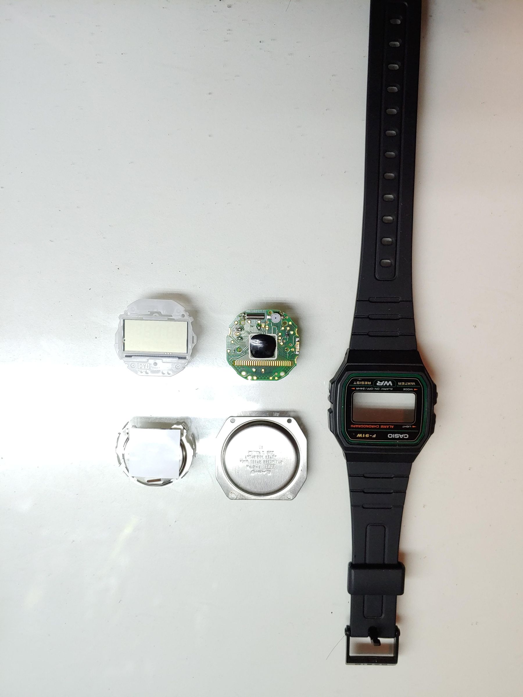

Step 2: Disassembly
Disassembly of the F91W is easy - There are only 4 screws holding the backplate to the watch body. The rest is snapped together and can be pry-ed apart with a small screwdriver fairly easily. See pictures for instructions.
Step 3: Closer Look at the Circuit Board
Identify the LED on the circuit board. The board is sparsely populated as most of the magic happens in the microprocessor encase in black resin. The LED is located near the side. The other components are the led resistor, quartz oscillator, an inductor, and pcb tracks to communicate to the LCD screen.
