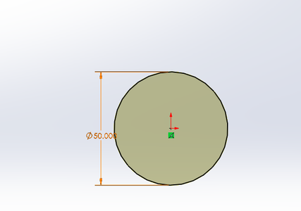

Sketch a circle on the top plane with a diameter of 50mm, like the picture above.
Step 2: The Case
Boss-extrude the circle by 5.5mm.

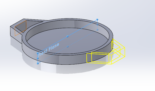

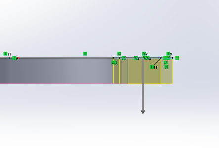

On the top face of the part, sketch a handle and dimension it like the photo above.
Step 6: The Case
Boss-extrude the sketch from step 5 up to the bottom of the part.
Step 7: The Case
Mirror the extruded feature using the front plane.

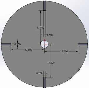

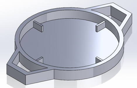

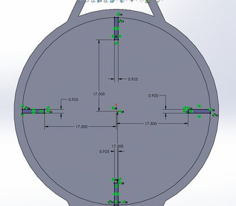

On the bottom face inside the part, sketch 4 rectangles centered around the origin. Make sure that the vertices are touching the inner circle, and dimension the rectangles like the pictures above.
Step 9: The Case
Boss-extrude the 4 rectangles up by 3.25mm
Step 10: The Case
When you have followed all the steps, your part should look like the part in the picture above.

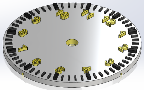

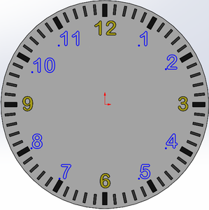

Step 11: The Dial
On the top plane, sketch a circle with a diameter of 45mm.

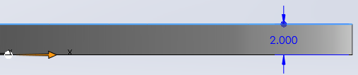

Step 12: The Dial
Boss-extrude the circle up by 2mm.
Step 13: The Dial

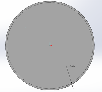

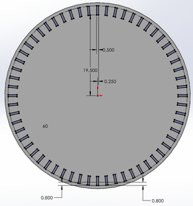

Start a new sketch on the top face of the part, then offset the circle by .8mm.
Step 14: The Dial
Sketch 1 rectangle with 2 vertices connected to the top of the circle. Once you have done that, add the dimensions in the picture above.
Step 15: The Dial
Use the circular sketch pattern following the direction of the circle with equal spacing. Set the number of instances to 60.
Step 16: The Dial

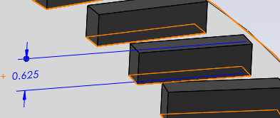

Boss-extrude the rectangles by 0.625 mm.
Step 17: The Dial

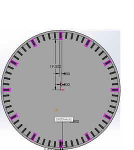

Sketch 1 rectangle with 2 vertices connected to the top of the circle from step 3. Once you have done that, add the dimensions in the picture above.
Step 18: The Dial
Use the circular sketch pattern following the direction of the circle with equal spacing. Set the number of instances to 12.
Step 19: The Dial
Boss-extrude the rectangles by 1 mm.
Step 20: The Dial

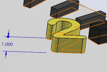

On the top face of the dial, start a new sketch and add the numbers on the dial. You can space them the way you want. You can also choose the font and size.
Step 21: The Dial
Boss-extrude the numbers by 1 mm.
Step 22: The Dial

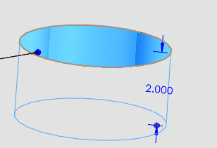

On the top face of the dial, sketch a circle that is centered at the origin and has a diameter of 4mm
Step 23: The Dial
Cut-extrude the circle by 2mm.
Step 24: The Dial

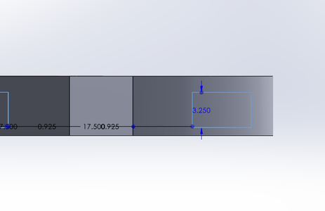

On the bottom face of the dial, sketch 4 rectangles. Add relations and dimensions to match the picture above.
Step 25: The Dial
Cut-extrude the rectangles into the dial by 1mm.
Step 26:
When you have followed all the steps, your part should look like the dial in the picture above

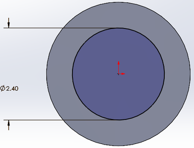

Step 29: The Hand

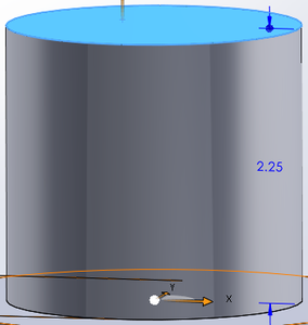

On the top face of the part, sketch a circle with a diameter of 2.4mm.
Step 30: The Hand
Boss-extrude the circle from the previous step by 2.25mm.

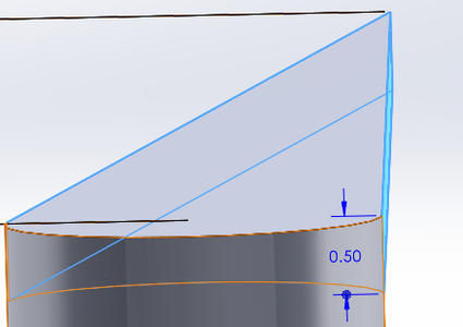

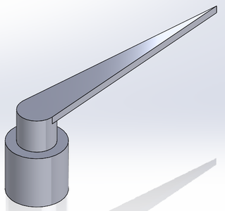

On the top face of the newly extruded circle, draw the same circle with the same diameter. Then, sketch 2 lines like a triangle, but make the bottom vertices tangent to the circle. Finally, add the dimensions and remaining relations to match the picture above.
Step 32: The Hand
Boss-extrude the sketch down by 0.5mm.
Step 33: The Hand
When you have followed all the steps, your part should look like the hand in the picture above
