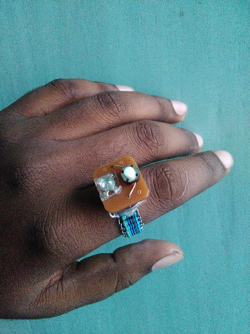

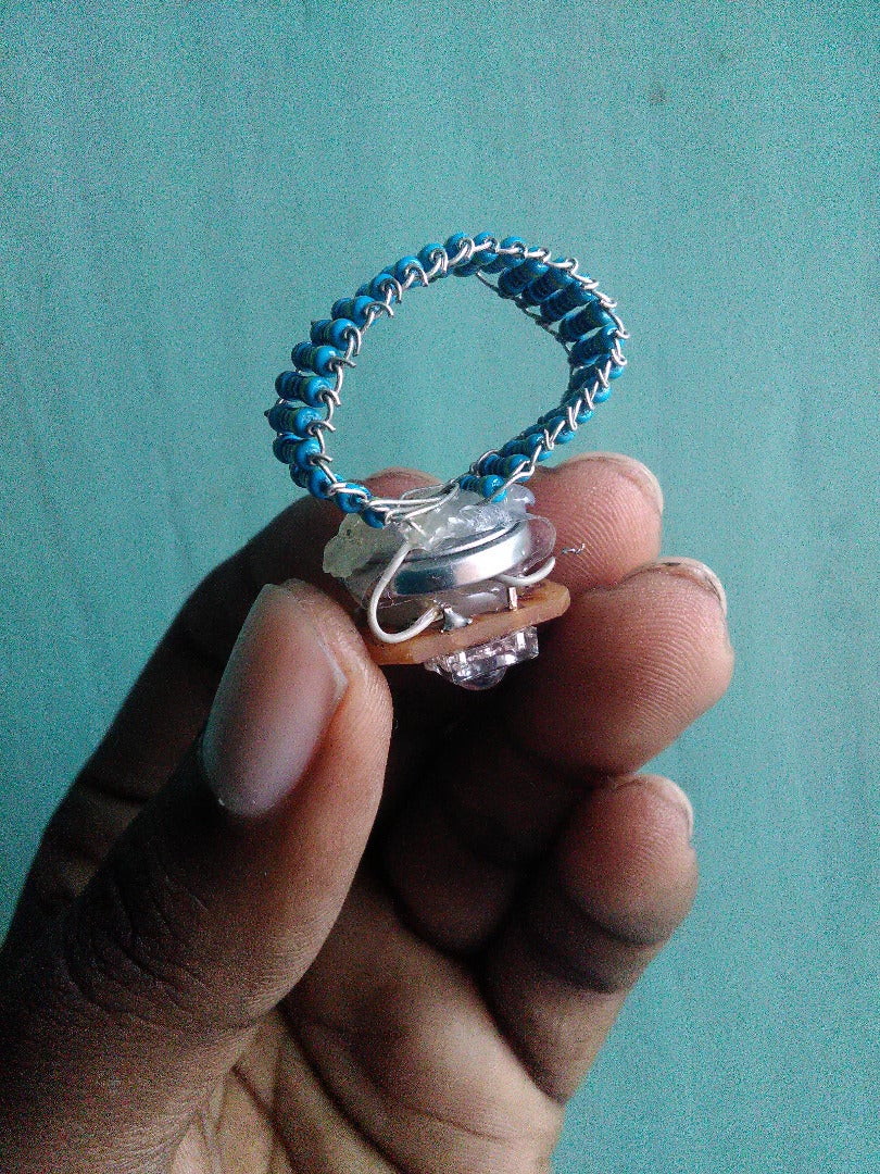

This is my another wearable project. Makers always like to use something made by their own & I am not different. I was thinking to made a watch ring for a month and finally I made it. It is very simple and you can make easily. ATtiny85 microcontroller and a RGB LED are the main components for the project. Time is shown by the RGB LED using different color. A button switch is attached to the watch and when it is pressed , LED will show you the time.
How?

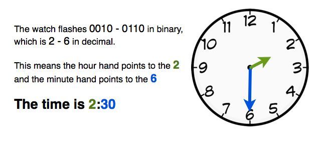

Let's explain, the first number represents the hour and the second number represents the number the minute hand would be pointing to if it were an analog clock. The green color represents 0 and the blue color represents 1. For example, if the watch flashes 0010 (GGBG) - 0110 (GBBG), this corresponds to 2 - 6, which means the hour is 2 and the minute hand points to the 6. It's 2:30. (Check out the image below for a graphic description!) There's no indication of a.m. or p.m., but hopefully it's clear whether it's 2:30 in the morning or not :) (Inspired by The Nerd Watch).
Image is taken from Nerd Watch.

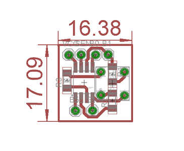

Step 3: PCB Layout
PCB layout was designed in eagle. Board file is attached.

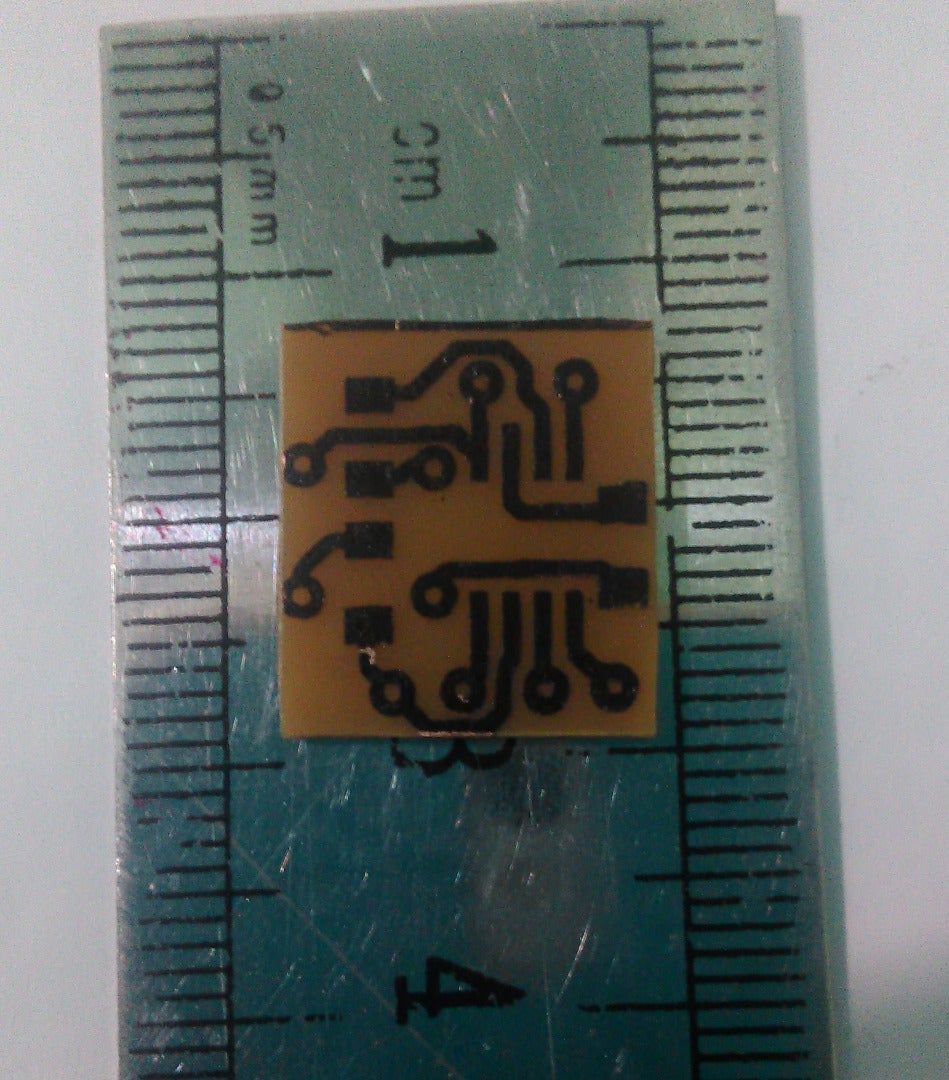

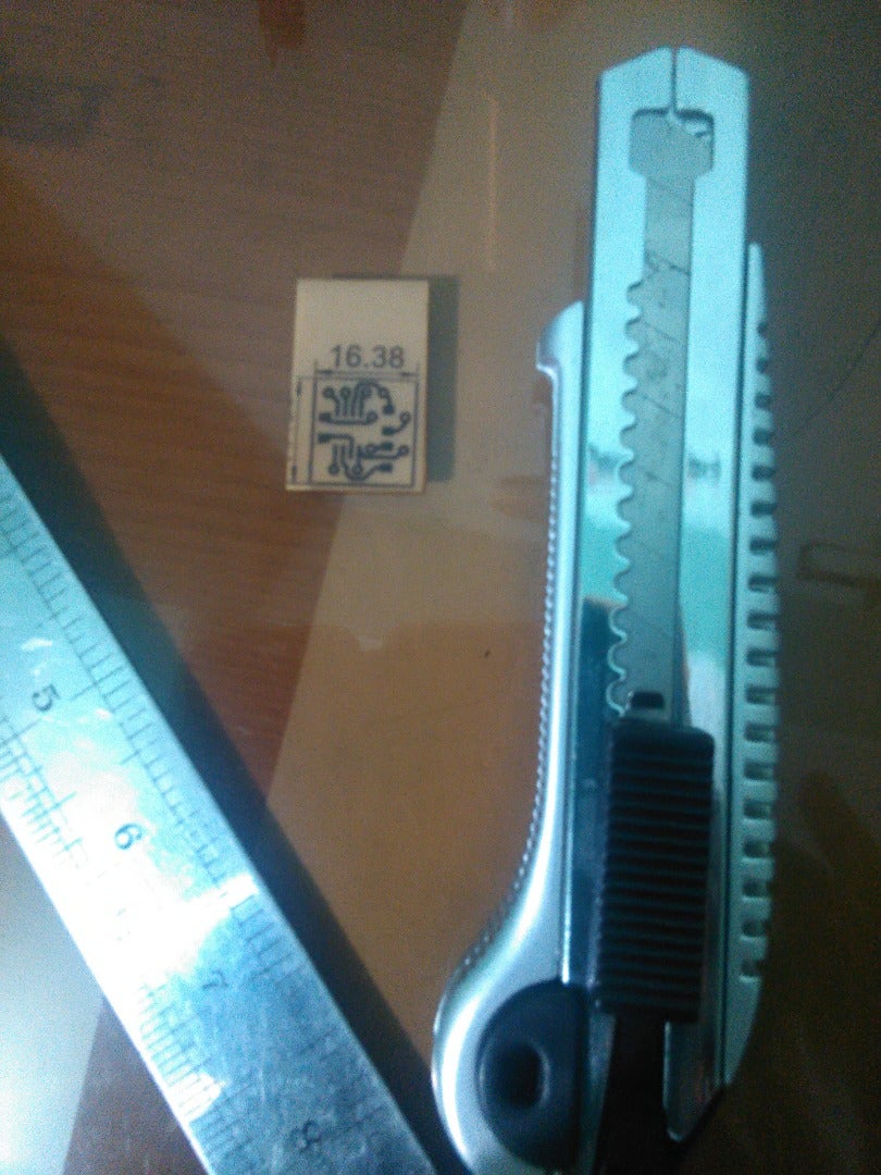

Step 4: Make the PCB
I made the PCB using toner transfer method. If you are new in PCB making follow the instructable:
Cheap and Easy Toner Transfer for PCB Making

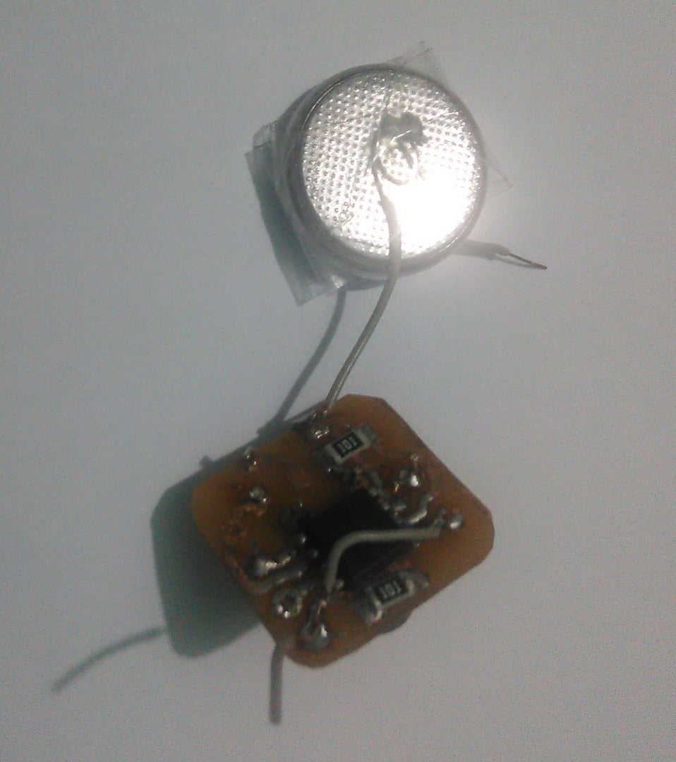

Step 6: Solder All the Components
Carefully solder all the component to the PCB board you made earlier. You need some experience in SMD soldering for that. Are you new in the field? Follow:

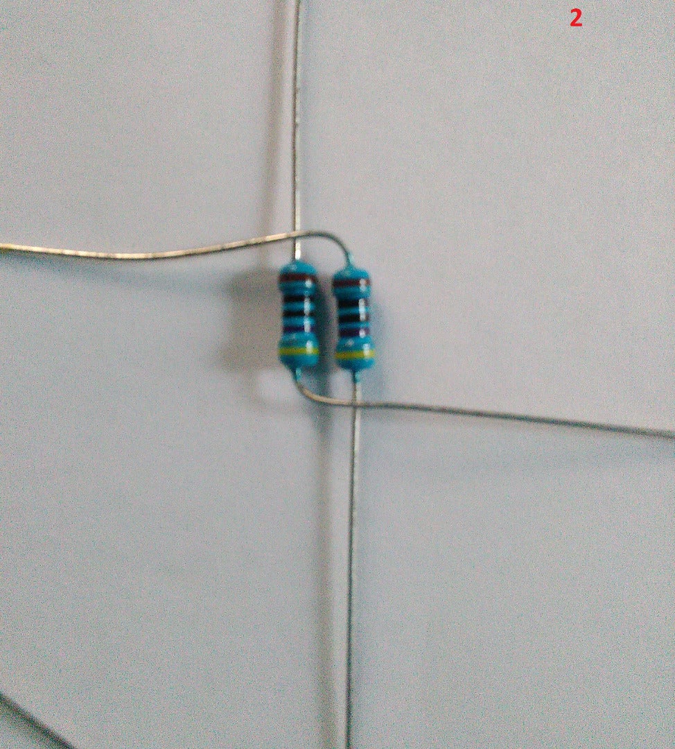

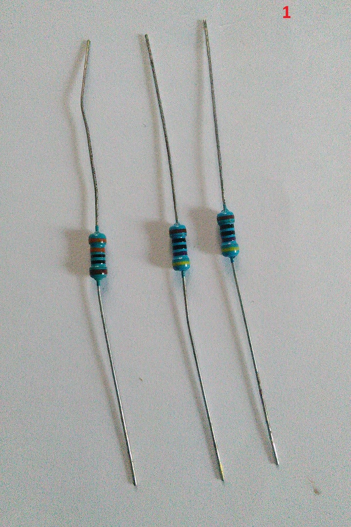

Step 8: Make the Ring

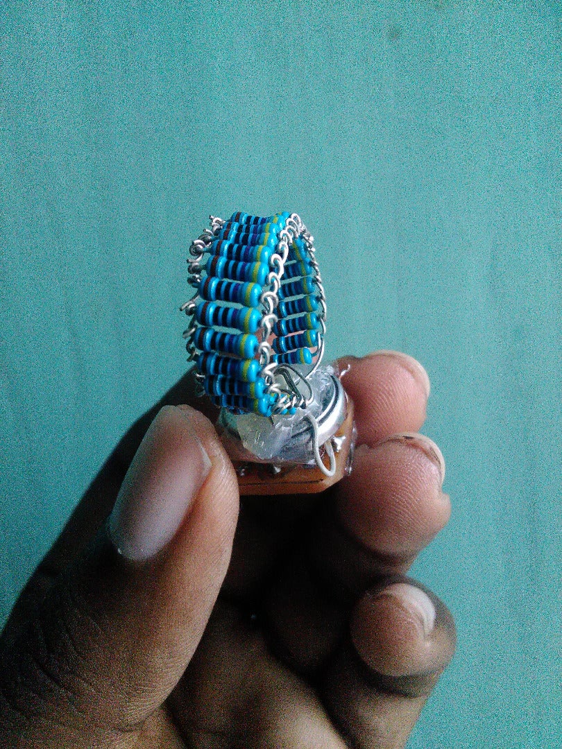

I used 1/4 W resistor to make the ring. I thing it the first time someone made a ring using resistor. 25 resistors is required to make the ring. You can used different colored resistor if you like. To make it just follow the images attached herewith.
Step 9: Finalized the Ring
Use a diagonal cutter or nail-cutter to cut the lags of resistors. Your ring is now ready. The ring is flexible enough and you can bend it easily.

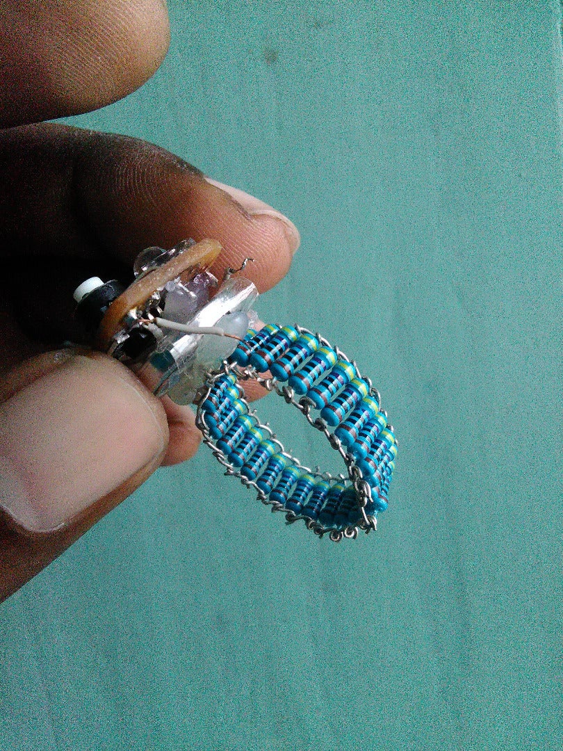

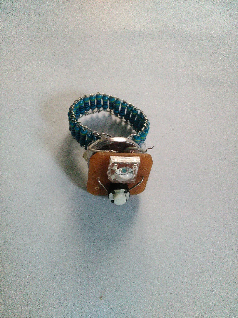

Step 10: Attached the Coin Cell to the PCB
Now, attached the 3 V coin cell to the PCB board using hot glue. Be careful! Don,t attached the battery side to the PCB directly. It will short the board. Two thing must be insulated from one another.

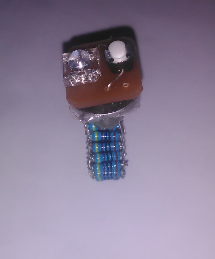

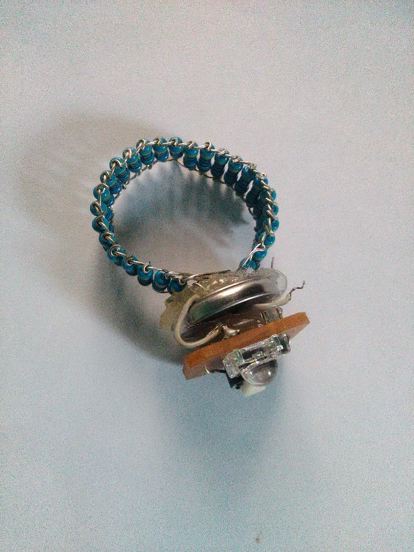

Step 11: Attach the Ring to PCB
Now attached the resistor ring to the PCB board as like in figure. You may use hot glue to do the job.

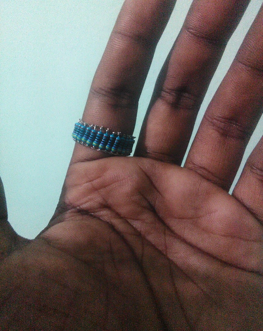

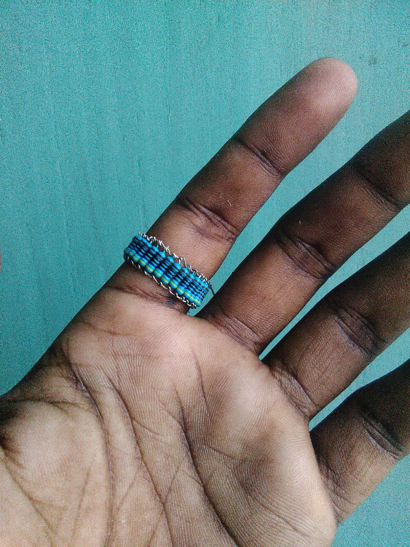

Step 12: Wear the Ring
Congratulation! You successfully mad the thing. Now it is the time to enjoy it. Wear it to the finger you like.
