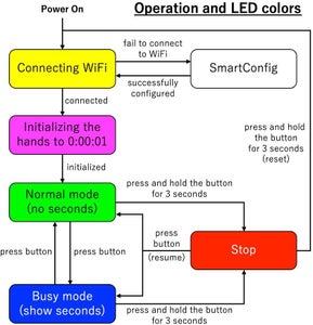

Step 4: Configure and Flash the Program
Open the program (clock.ino) and edit it.
  • Timezone: please set your time zone (time difference from GMT).
  • Edit WiFi SSID and password.
  • Edit the time to turn on and off the busy mode automatically. It is recommended to set the time to switch to the busy mode in the morning, because you can confirm the correctness of your watch when you wear it.
  • This winder rotates approx. 20 turns per hour (10 CW and 10 CCW) during normal mode. Therefore, normal mode is not sufficient to keep the watch working and busy mode (200 turns per hour) should be added. Usual watches need 650-1600 turns per day. You can find resources to confirm the recommended rate (TPD).
  • SmartConfig is possible to use when you turn on the flag. You can set SSID and password using smartphone apps.

Step 6: Operation
  • The mode of this watch winder is indicated by the color of LED on M5Stamp C3.
  • Basically, short press of the button switches between normal and busy mode.
  • Long press (hold 3 seconds) stops the winder. Long press again to reset.
