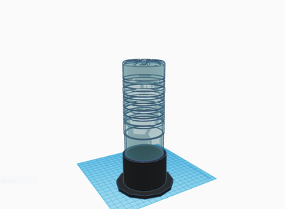

Step 1: Build the Bottom of the Base
On Tinkercad, grab a cylinder and set the dimensions to 100mmx100mmx5mm. Grab another and set it to 6.35mmx6.35mmx5mm (Maybe thicker if you want it to be sturdier, but this should hold well). On the small cylinder, center a hole 4.83mmx4.83mmx5mm. Group the small cylinder and hole then duplicate it 3 or 4 times (or as many screw holes you would like). align them with the corners of the large cylinder then group.
Step 2: Build the Large Support
Grap a new cylinder and size it up to75mmx75mmx52mm. Do the same step you did with the screw holes with a hole 68mmx68mmx52mm. center and group with base.
Step 3: Make the Cap Holder.
This shape can be smaller if you want to skip the hassle of gluing bottles with smaller lids, but mine is. the largest I would recommend. Make a cylinder 49.53mmx49.53mmx18mm. Make a hole 40.8mmx40.8mmx18mm. Raise the hole five millimeters off the ground. Center and group with the cylinder and then the base

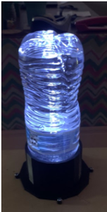

Step 4: Put Light in Bottle & Put Bottle in Base
Take out the tab in the light; it will immediately turn on. stick in in the water bottle and attach it to the base. Turn off the light to see it in action. Not as strong as the design I based it on, but it lasts at night. Lasts 3 days.
