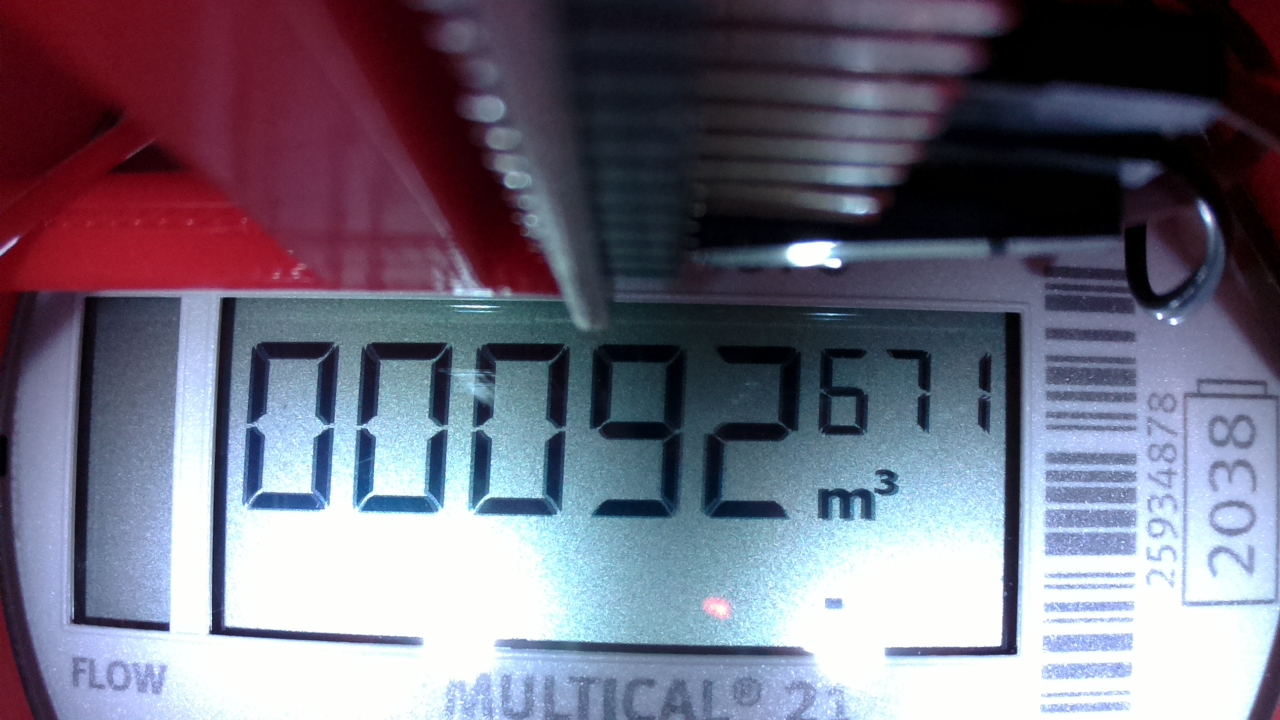

The hardware consists of a Raspberry Pi mini computer and its camera. The camera is positioned above the digital water meter, capturing images of the water consumption digits. These images are analyzed, and the data is sent by the Raspberry Pi to the ThingSpeak cloud. In the cloud, the values are further processed and presented in charts. This process is repeated every minute.
This setup is specifically tuned to work with Kamstrup MULTICAL 21 water meter models. See the pic.

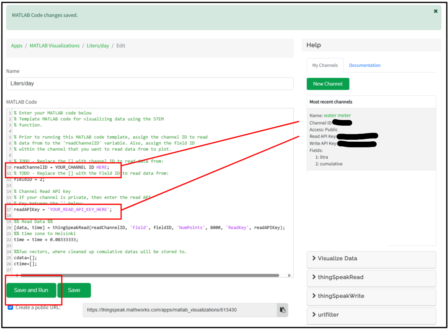

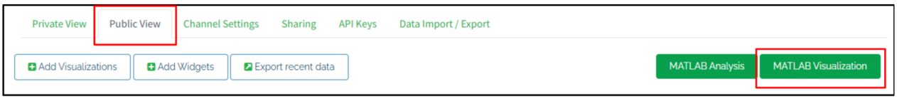

Copy and Modify the MATLAB Code:
  1. Select the Public View tab and click on the MATLAB Visualization button.
  2. Click Create
  3. Copy and paste the attached MATLAB code.
  4. Modify the code by adding your ChannelID and Read API Key.
  5. Save and close the file.

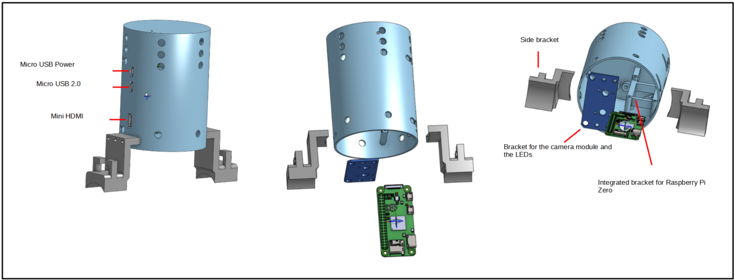

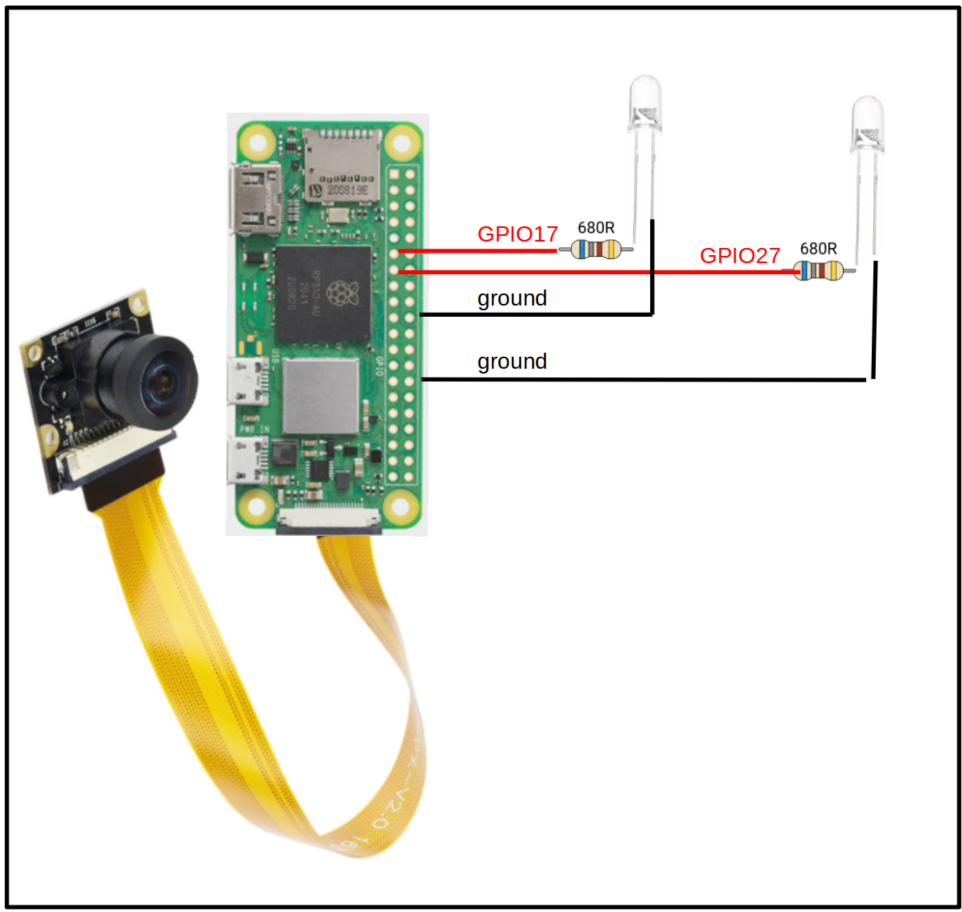

Step 3: Assembly
Make the connections:
  1. Refer to the image for guidance and ensure all components (camera, flex, resistors, LEDs, pin header cables) are connected and soldered properly.
Print the mechanical parts:
  1. 3D-print all four mechanical parts as required.
Assemble the camera and LED:
  1. Attach the camera and LED to the 3D-printed bracket plate.
  2. Install the assembled plate along with the Raspberry Pi Zero into the housing.
Secure the side brackets:
  1. Use screws to fasten the side brackets firmly.
Position the housing:
  1. Place the housing securely on top of the water meter.
  2. Use rubber bands to hold it in place.

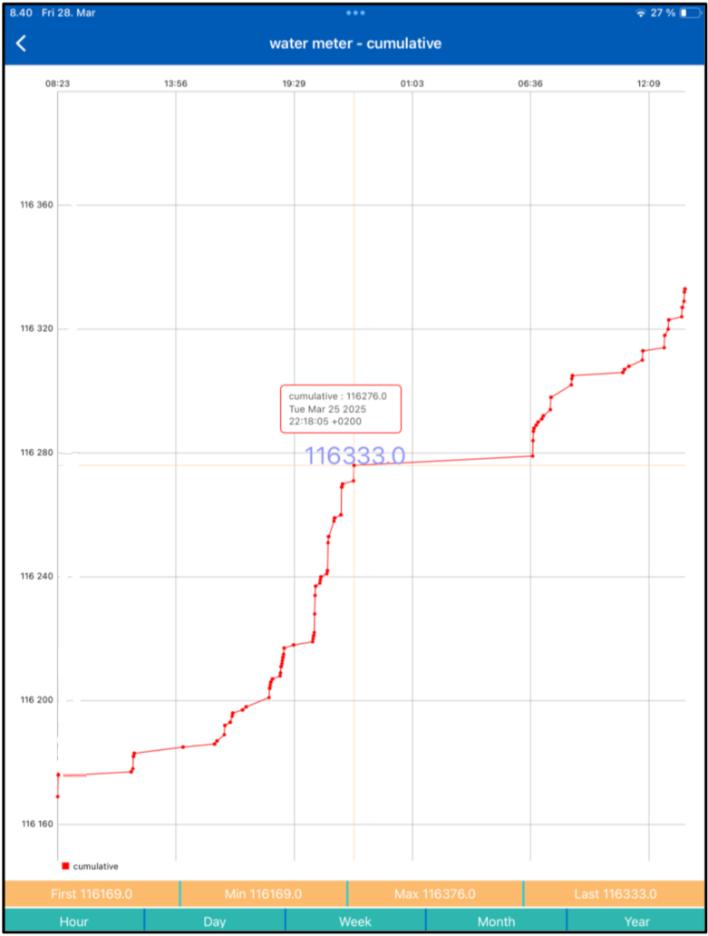

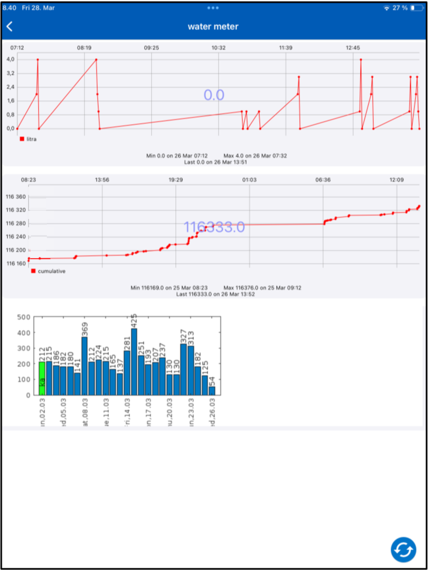

Step 4: User Interfaces and Outputs
There are two options available to monitor your water consumption data:
ThingSpeak Web Page:
  1. Access and analyze your water usage directly through the ThingSpeak platform in a web browser.
ThingView Mobile App (Android, iOS):
  1. Download the ThingView app to conveniently monitor your water consumption on the go.
  2. The app is available for both Android and iOS devices.

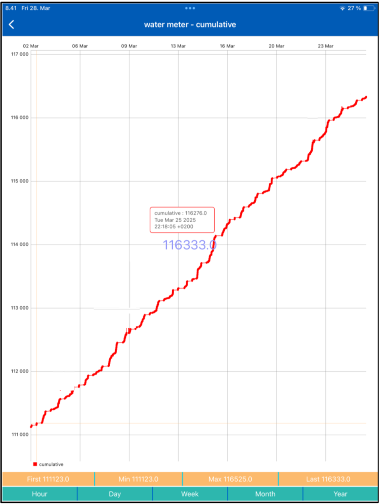

  3. Here are some example images captured from the ThingView Free app on an iPad to give you an idea of how it looks.
Overview
The green bar on the left side of the bottom chart represents the average water consumption per day, calculated across all recorded days.
Cumulative all
By clicking on the top of the middle chart, the overall cumulative curve is displayed in full-screen mode.
Cumulative zoomed
You can zoom into the cumulative results by using the buttons located on the bottom line, which include options such as Hour, Day, Week, Month, and Year. This allows you to view the data over different time intervals effectively.

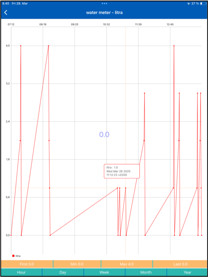

Liter zoomed
Clicked on the top of the liter curve and selected Day View to display the daily data trend effectively.

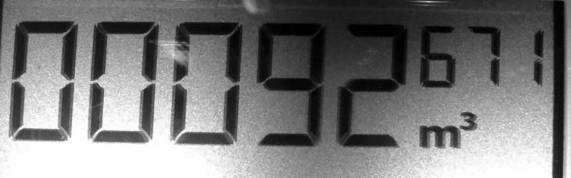

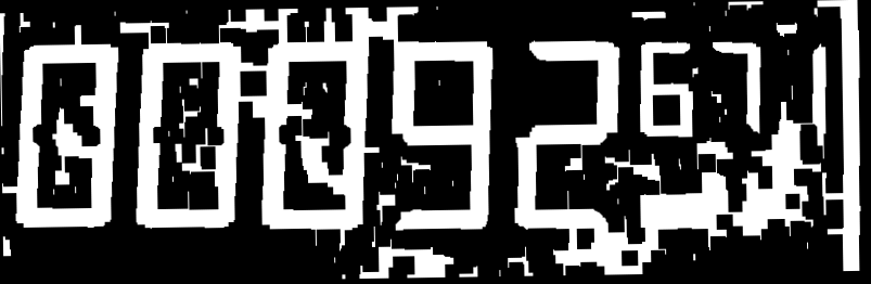

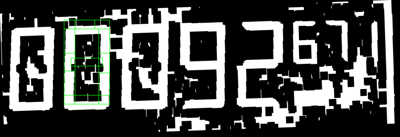

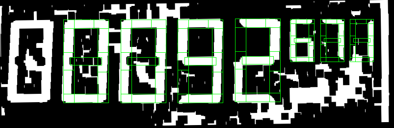

Step 5: Camera Image Processing
The series of operations has been performed on the captured image to enhance and analyze information. Below are the steps described as executed in the Python script:
Image Acquisition: Capturing the raw image using a camera sensor.
Segmentation: isolating specific region of interest within the image.
Grayscale Conversion: In this step, the image transitions from the RGB color format to a single-channel GRAY scale format.
Pre-processing: Adjusting brightness, contrast. Converting black to white and white to black.
Rotation Calibration: This step ensures the image is rotated to achieve horizontal alignment, which is critical for accurate data analysis. It is carried out at the start of the Python script in a for loop.
Image Analysis: This step focuses on analyzing the digits within the captured image. The digits are identified as numerical values.
