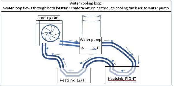

I saw an image on the Raise3D pro2 forums for a water cooling attachment designed by Paul Yarnall that replaces the main cooling fan and the air-cooled heat-heat sinks used in the Raise3D Pro2 with a water cooled system. I liked the idea of fewer jams and faster printing and decided to design my own version that can be made in a home shop from either aluminum or copper. Copper has the best thermal conductivity of any metal found in a workshop, being twice as good as Aluminum, but Aluminum is much cheaper, and easier to get a hold of, and more corrosion resistant. Copper may be preferred though if working with higher temperature filaments or higher production speeds are needed.
This Instructable is for my own open-source design for a water cooling system for the Raise3D Pro2, and it has NOT been endorsed by Raise3D or by Paul Yarnall (yet). I hope you like it.

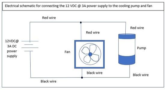

POWER SUPPLY:
34) A 12V 3A DC power supply. (Used for both the water cooling system pump and water cooling system fan). The Raise3D Pro2 cannot supply enough power to run both the cooling pump and cooling fan at the same time.
35) power bar (connect both the Raise3D pro2 and the 12VDC power supply for the cooling system to the power bar to turn everything on at once)

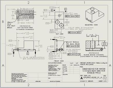

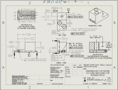

DRAWING PLANS
36) Copy of plans for making the part (please forgive my GD&T, I'm trying to get better). The drawing is provided under a Creative Commons license and is free to reproduce or modify. The design IS NOT ENDORSED BY RAISE3D, USE AT YOUR OWN RISK.
Step 1: Study the Plans and Order the Parts
Plans were drawn up using Solidworks. Study them prior to doing anything. The dimensions are given in mm because the dimensions of the heatsink were initially measured in mm.
I have added some tolerances, which people should be able to maintain. Pay attention to the water channels. If everything is done to exact tolerances, then the expected wall thickness at the thinnest points will only be 0.043" / 1.1mm. If you go outside the tolerances, there is a chance that you will either make a leak-point through a wall, or that you will have too little contact space for the 10-24x1/8 setscrews to be able to block water leaks.
Try to stay within tolerances given, and try to understand WHY we have positioned things the way we have in this heatsink
(EX: The holes for the 1/8-27 MNPT fittings are offset some distance apart, but if they were spaced closer together, then there would be no space to attach the fittings without them bumping into each-other)

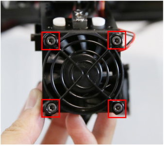

Step 2: Understanding the Design Constraints, Looking at the Heat Sink of the RAISE3D PRO2, and the Space Constraints for the Heatsinks
This is the original extruder for a Raise3D Pro2 (see figure 1).
The heat sink is held on using a small setscrew. Loosening the setscrew allows the heatsink to be removed/replaced.

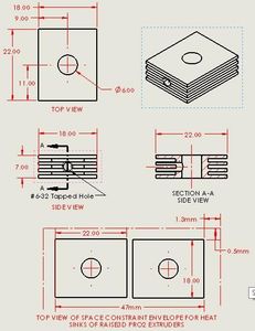

There is a diagram included that shows the space constraint envelope that the cooling fins of the raise3D Pro2 must fit within. Any heatsink we make MUST fit within the envelope shown in the diagram.

At this point you have a square piece of aluminum that fits within the L/W/H envelope of
L = 42mm-43mm
W = 22mm - 22.5mm
H = 25mm - 25.5mm

Step 10: Understanding the Water Cooling Loop
A 3D printer feeds filament into a heated chamber where it melts and is pushed out the nozzle. If the heat from the heater travels too far past the heat-break, then the filament will melt or soften prematurely, requiring extra effort to push, and it may form plugs and blockages stopping filament from being fed into the nozzle.
The heat break is a tube in the extruder of the 3D printer that is supposed to limit the flow of heat from the heater block to the rest of the 3D printer. They often have a narrow part that reduces heat transfer from the heater block to the rest of the 3D printer. Often heat breaks have active cooling systems like a cooling fins and fan based cooling, or water cooling.
For this project, we are making water cooled heat-sinks that uses a flow of cooling water inside of internal channels to cool the heat-break more effectively than the air cooled heat sinks that were being used before.
The water cooling loop is made by drilling channels into the block, and then either screwing tube attachments to the block, or inserting threaded set screws into the holes to block leak-paths.
Hole #1: is the 6mm mounting hole (same diameter as the one holding the original heatsink onto the heat break)
Hole #2: This hole is for part of the water channel that gets blocked with a setscrew.
Holes #3 & #4: These two holes make most of the water loop, and their leak points get blocked with setscrews
Holes #5 & #6: These are the 1/8-27 NPFT holes drilled into the block where the hose connectors will be attached.
Hole #7: This is the hole for the #6 setscrew that fixes the heatsink into place on the heatbreak.

To mark out the location of hole #2,
1) we used the vernier calipers to scribe/scratch coordinate lines for hole #2 (marking a line at Y= 3mm+-0.3, Z = 3.5mm+-0.3). If necessary.
2) We then used a carbide scribe as a precise punch to make a small but precise centering hole (or more precisely a centering indentation). In our case the carbide scribe had a ceramic magnet on the top, so we could not hit it with a metal hammer. Instead we recommend using a block of wood, or a rubber mallet to tap the scribe into the aluminum block to make the precise centering hole.
3) There is a small centering hole for locating hole #2, but it needs to be larger. Take a center punch, put it in the centering hole, and hit it with a hammer to enlarge the centering hole for hole #2
Step 14: Drill Hole #2 Using #2 Center Drill and #25 Drill Bit.
Now that we have made the centering hole for hole #2 We will drill a centering hole using a #2 center drill and a 19.5+-0.5mm deep hole using a #25 drill bit. Hole position for Hole #2 should be Ycoord = 3mm +- 0.3mm Zcoord = 3.5mm +- 0.3mm
TOOLS USED:
a) a levelled drill press with levelled drilling platform and drill chuck key.
b) Clamping system (ex: vise). In this case we use a Kant-Twist Quick acting clamp that has been connected to the drill press platform.
c) Brush to remove chips
d) #2 center drill
e) #25 drill bit (diameter 0.1495" = 3.7973mm).
f) Cutting fluid
g) electric tape to mark drill depth.
h) eye and ear protection
i) manal drill (optional)
Steps
1) MAKE SURE DRILL IS OFF. Clear all chips and dust from the surface of the drill press platform
2) Set the vernier calipers to a length of 19mm, put the #25 drill bit next to it, and now wrap some tape onto the drill bit to mark a depth of 19mm on the #25 drill bit.
3) Load the #2center drill into the drill chuck
4) Put the clamping system onto the drill platform and start positioning the workpiece
5) Position the piece for drilling by manually lowering the center drill bit into the centering hole for hole #2.
5) Clamp the piece firmly in position
6) Raise the drill bit, add some cutting fluid over the centering hole
7) TURN DRILL ON. Drill a centering hole in the piece. just the tip and a little countersink, but kept the center hole diameter under 0.1495" (3.7973mm).
8) TURN OFF DRILL.
9) Change the drill bit to the #25 drill bit marked with the tape at 19mm depth. Verify the drill bit is still centered with the hole.
10) Put some cutting fluid on the #25 drill bit and center hole
11) DO NOT TRY TO DRILL TO DEPTH IN ONE GO. Instead peck-drill into the piece so that chips are cleared out regularly. If necessary use more cutting fluid. Peck drill until the piece of tape (our depth stop touches the surface of the piece).
12) Remove the piece from the clamp, clear away chips from the drilling platform and the surface of the piece, and clear out any chips from the hole (use water if needed).
13) To check the hole depth use the depth measuring end of the vernier caliper to measure the depth of Hole #2 (should be 19.5mm +- 0.5mm in depth)
14) If the hole depth is UNDER TOLERANCE (below 19mm in depth), then put the #25 drill bit back in the drill chuck, and VERY GENTLY drill out the hole until the depth of Hole #2 is between 19mm to 20mm. (CLEAN OUT THE hole regularly and remove from clamping, clean out the hole and recheck the depth as needed. You can even use a manual drill if desired since the hole will already locate the drill.
15) Once drilled to depth we verify the position of hole #2. To check the hole position, we insert the #25 drill bit into hole #2, and use it as a measuring dowel. Use this formula to check if the hole is in the correct pace.
D = drill diameter (which is the same as hole diameter)
Ycoord = x-coordinate of hole center as measured from datum
Zcoord = y-coordinate of hole center as measured from datum
y = Ycoord + D/2
z = Zcoord + D/2
EX: In this case, given D = 0.1495"=3.7973mm , D/2 = 1.8987mm
& given Ycoord = 3mm+-0.3 & Zcoord = 3.5mm +-0.3
By inserting the drill into the hole and using the vernier calipers to measure from the datum surfaces to the outside of the drill, we should measure
y=4.90+-0.3mm = (Ycoord = 3mm+-0.3) + ((D=3.7973mm)/2),
z = 5.40 +-0.3mm) = (Zcoord = 3.5mm+-0.3) +((D=3.7973mm)/2)

Step 15: Locating and Marking Holes #3 & #4, and Hole #7
Holes #3 & #4 are part of the water cooling channel. They drill down into the channel left by hole #2
Hole #7 is used to allow a setscrew to be threaded up to the heatbreak inserted into hole #1 so the heatsink stays in position.
(*FATAL) If Holes #3 or #4 are out of positional and cylindricity tolerances. then the drill will cut into the walls of the 6mm hole, or the side walls, and this will destroy the piece (because it will be leaky). If they go all the way through the piece, then it can't be plugged with a setscrew, because there will not be enough depth it insert setscrews without blocking the water channel made by hole #2.
(*FATAL) If hole #7 is out of positional or cylindricity tolerances, then it could cut into the walls of the water cooling channels and make leak points.
This is why it needs to be both within depth tolerances, and within positional tolerances and cylindricity tolerances.
Use the same steps as hole positioning for hole #1 and hole #2.
The mark of success for this project is
a) The heat sink fits within the required space envelope.
b) The assembled heat sink does not leak.
TOOLS USED:
a) Vernier Calipers
b) fine tipped carbide scribe
c) wood block or rubber mallet to tap on the carbide scribe
d) Center punch
e) hammer
f) Copy of the plans
To mark out the location of holes #3 & #4 & #7,
1) HOLE #3: we used the vernier calipers to scribe/scratch coordinate lines for hole #3 (marking a line at Xcoord= 5mm+-0.3, Z = 3.5mm+-0.3).
2) HOLE #4: we used the vernier calipers to scribe/scratch coordinate lines for hole #4 (marking a line at Xcoord= 17mm+-0.3, Z = 3.5mm+-0.3).
3) HOLE #7: we used the vernier calipers to scribe/scratch coordinate lines for hole #7 (marking a line at Xcoord= 11mm+-0.3, Z = 2.5mm+-0.3).
4) We then used a carbide scribe as a precise punch to make small but precise centering holes (or more precisely centering indentations). In our case the carbide scribe had a ceramic magnet on the top, so we could not hit it with a metal hammer. Instead we recommend using a block of wood, or a rubber mallet to tap the scribe into the aluminum block to make the precise centering holes for Hole #3, Hole #4, & Hole #7.
3) There are now small centering holes for locating holes #3, #4, #7, but they need to be larger. Take a center punch, put it in the centering holed, and hit it with a hammer to enlarge the centering holes for holes #3, #4, & #7
Step 16: Drill Holes #3 & #4 to 39mm +-0.5mm. Use #2 Center Drill and #25 Drill Bit
Now that we will drill holes #3, & #4.
GOAL: Drill holes #3 & #4 until they merge with the channel from hole #2
Using our previously made centering indentations for holes #3 & #4, we will drill a centering holes using a #2 center drill and 39mm+-0.5mm deep holes using a #25 drill bit.
  • Hole position for Hole #3 should be Xcoord3 = 5mm +- 0.3mm Zcoord3 = 3.5mm +- 0.3mm.
  • Hole position for Hole #3 should be Xcoord3 = 17mm +- 0.3mm Zcoord3 = 3.5mm +- 0.3mm.
TOOLS USED:
d) #2 center drill
f) Cutting fluid
k) toothpick longer than 30mm
Steps
2) Set the vernier calipers to a length of 38mm, put the #25 drill bit next to it, and now wrap some tape onto the drill bit to mark a depth of 38mm on the #25 drill bit.
3) Load the #2 center drill into the drill chuck
5) Position the piece for drilling by manually lowering the center drill bit into the centering hole for hole #3.
8) TURN OFF DRILL.
9) Change the drill bit to the #25 drill bit marked with the tape at 39mm depth. Verify the drill bit is still centered with the hole.
10) Put some cutting fluid on the #25 drill bit and center hole. Put the toothpick into hole #2
11) DO NOT TRY TO DRILL TO DEPTH IN ONE GO. Instead peck-drill into the piece so that chips are cleared out regularly. If necessary use more cutting fluid. Peck drill until the piece of tape (our depth stop touches the surface of the piece). Now keep going slowly until the #25 drill bit breaks through into Hole #2 and the toothpick starts wiggling.
12) Remove the piece from the clamp, clear away any chips from the drill platform, the piece, and from hole #2 and #3.
13) Looking down hole #2, verify by eye that the channel for Hole #3 meets up with the channel for Hole #2 by seeing if a #25 drill bit is pushed into hole #3, that it can reach the center of Hole #2.
14) if necessary, clean up the sides of hole #2 by using the #25 drill bit to clean the sides of hole #2.
15) repeat steps 3 to steps 14 for hole #4
16) Remove the piece from the clamp, clear away chips from the drilling platform and the surface of the piece, and clear out any chips from the hole (use water if needed).
17) 15) Once drilled to depth we verify the position of holes #3 & #4. To check the hole position, first we check to see if there are any breaks in the sides of the walls, then we insert the #25 drill bit into holes #3 & #4, and use it as a measuring dowel. Use this formula to check if the hole is in the correct pace.
Xcoord = x-coordinate of hole center as measured from datum
X = Ycoord + D/2
Z = Zcoord + D/2
& given Xcoord3 = 5mm+-0.3 & Zcoord3 = 3.5mm +-0.3
& given Xcoord4 = 17mm+-0.3 & Zcoord4 = 3.5mm +-0.3
For Hole #3: we should measure
Y3=6.90+-0.3mm = (Ycoord = 5mm+-0.3) + ((D=3.7973mm)/2),
Z3 = 5.40 +-0.3mm) = (Zcoord = 3.5mm+-0.3) +((D=3.7973mm)/2)
For Hole #4: we should measure
Y4=18.90+-0.3mm = (Ycoord = 17mm+-0.3) + ((D=3.7973mm)/2),
Z4 = 5.40 +-0.3mm) = (Zcoord = 3.5mm+-0.3) +((D=3.7973mm)/2)
We will skip tapping and plugging Holes #3 & #4 until all of the holes #3/#4/#5/#6 have been drilled
TOOLS USED:
d) #2 center drill
e) #35 drill bit (diameter 0.11" = 2.794mm) or 7/64" drill bit D= 0.1094" = 2.778mm)
f) Cutting fluid
i) manual drill (optional)
j) 6mm drill bit (to clean up Hole #1)
Steps
2) Set the vernier calipers to a length of 32mm, put the #35 drill bit next to it, and now wrap some tape onto the drill bit to mark a depth of 32mm on the #35 drill bit.
4) Put the clamping system onto the drill platform and start positioning the workpiece for hole #7
5) Position the piece for drilling by manually lowering the center drill bit into the centering hole for hole #7.
7) TURN DRILL ON. Drill a centering hole in the piece. just the tip and a little countersink, but kept the center hole diameter under 0.1" (2.54mm).
8) TURN OFF DRILL.
9) Change the drill bit to the #35 drill bit marked with the tape at 32mm depth. Verify the drill bit is still centered with the hole.
10) Put some cutting fluid on the #35 drill bit and center hole
11) DO NOT TRY TO DRILL TO DEPTH IN ONE GO. Instead peck-drill into the piece so that chips are cleared out regularly. If necessary use more cutting fluid. Peck drill until you drill into hole #1 (The tape is a useful secondary reference) (our depth stop touches the surface of the piece). REMEMBER, THIS IS A THIN DRILL BIT AND CAN SNAP MORE EASILY THAN THICKER DRILL BITS. BE CAREFUL.
12) Remove the piece from the clamp, clear away chips from the drilling platform and the surface of the piece, and clear out any chips from the hole (use water if needed). Verify that Hole #7 reaches hole #2. Also verify that Hole #7 does not cut into channels from holes #3, #4, #5, #6
13) if necessary, clean up hole #1 using a 6mm drill bit.
We will skip tapping Hole #7 until all of the holes #3/#4/#5/#6 have been drilled, and we have removed the cut-out block

Step 27: Disconnect Main Cooling Fan, and Wire in the New Heatblocks.
We cannot use the Raise3D Pro2 to power the water cooling system.
Both the cooling fan and our pump use 12 VDC power. Unfortunately the control board on our Raise3D Pro2 CANNOT source enough amps of current to power our water recirculation pump and our water cooling fan. This means that even if we make a spliced cable to the Raise3D heater control board(*3), we would be unable to use that connection to draw enough current to power our external cooling equipment.
For this setup I have a 12VDC power supply wired to both the pump and the water cooling fan, and plugged into the same powerbar that feeds power to my Raise3D pro2 printer.
NOTE1: The main cooling fan has to be disconnected from the heater control board, but the left & right cooling skirt fans have to stay
NOTE2: I had previously damaged my heater block heaters so I had to replace them. If your heater blocks were already connected properly, then simply unplug the main cooling fan from the board and remove the fan. Do not rewire the heater cartridge wiring or the thermocouple wiring unless needed. Most people can simply replace the previous heatsinks with the new heatsinks without needed to replace wire connections to anything except the main cooling fan.
NOTE3: The connectors for the fans on the Raise3D pro2 heater control board are JST-XH 2.5mm connectors. If you want to connect to them use JST-XH extension cables from digikey (Digikey part-number 1528-5497-ND).
We also cannot add the water cooled heatsinks unless we remove the left and right cooling skirts in order to get at the mounting collars.
Tools:
a) Allan Key set included with the Raise3D pro2
b) Wire cutters (for cutting the twist ties holding cables together
c) this flat screwdriver (for unscrewing the wires connected to terminal blocks that need changing)
d) zip ties (3) to replace the zip-ties that we cut.

b) Remove both left and right fan skirts. Unscrew them both so you can access the collars that attach the left and right heater blocks onto the 3D printer. Save all your screws and pieces.
c) unscrew the screws that hold the main cooling fan attached the the 3D printer. pull off
  • the grate
  • The fan
  • the fan holder that the fan was mounted on.
Once the fan holder is removed you can see the mechanism that raises and lowers the two extruders.
d) Loosen the collars on both the left and right extruders so that they can be withdrawn from the 3D printers.
e) Locate the connection on the control board where the main cooling fan is located. Unplug that connector. In my case I undid the screws connecting the filament drivers so I could access the board and change the cables for the left extruder heater and left extruder thermocouple in addition to removing the fan connector. Lifting this part off made it easier to remove the cable for the front cooling fan.
f) remove the cabling for the main cooling fan. If the cables are zip tied together, then remove the zip ties, remove the fan cable, and re-zip tie the cable assembly for ease of management.

Step 29: Set Up the Cooling Pump and Cooling Fan. Splice in the 12VDC Power Supply
The cooling fan and cooling pump need to be wired up to a 12VDC power supply and put on a mounting. I used a 12VDC wall wart powerr supply capable of supplying 3Amps that I spliced in to power both the fan and the pump simultaneously.
Materials: (these are included in the E3D cooling pump kit)
a) E3D cooling pump
b) E3D cooling fan
c) 8mmOD / 5mmID silicone tubing
d) tube adapters (5mm hose barb to 4mm tube)
e) pump mounting clips
Materials (Extra bits required)
f) Wood for making the mounting
g) 12VDC wall wart capable of supplying min 3@ (minimum 36 watt 12VDC power supply) (Available everywhere). Make sure the cable is at least 48" long.
h) soldering iron/solder/flux
i) red and black heat-shrink tubing (I like marine heat-shrink tubing with the glue)
j) Digital multimeter
k) zip-ties
l) knife for cutting off extra from zip-tie
Instructions:
a) Take the wall-wart, make sure it is unplugged, and cut off the end of the power connector cable. Make sure that at least 45" of cable is still attached to the wall-wart.
b) separate the ends of the cable and use the digital multimeter to find the +12VDC cable, and the GND cable on the wall wart. Identify the 12VDC cable as RED, and the GND as BLACK.
c) Slip a length of RED heat-shrink tubing on the +12 VDC cable of the wall-wart, and a length of BLACK heat-shrink tubing on the GND cable of the wall-wart.
d) Expose some of the copper at the ends of the RED wires of both the cooling fan and the cooling pump. (Note the pump has a white wire. I ignored it)
e) Twist the exposed ends of the RED wires of both the cooling pump and the cooling fan together with the 12VDC wire of the wall-wart. Apply some flux, wrap some solder wire around the twisted splice, and solder all three wires together.
f) when the solder joint has cooled, slip the RED heat-shrink tube up over the solder joint, and heat up the heat-shrink with the soldering iron.
g) Slip a length of BLACK heat-shrink tubing on the GND cable of the wall-wart.
h) Expose some of the copper at the ends of the BLACK wires of both the cooling fan and the cooling pump.
i) Twist the exposed ends of the BLACK wires of both the cooling pump and the cooling fan together with the GND wire of the wall-wart. Apply some flux, wrap some solder wire around the twisted splice, and solder all three wires together.
j) when the solder joint has cooled, slip the BLACK heat-shrink tube up over the solder joint, and heat up the heat-shrink with the soldering iron. Now when the wall-wart is plugged in, it will power both the cooling fan and the cooling pump at the same time.
k) Build a wooden mount for mounting both the cooling pump and the fan. Use you own judgement for placement of pump and fan.
l) cut silicone tubing and attach the fan to the pump INLET.
j) cut tubing and connect the other fan connection to an adaptor (5mm hose barb to 4mm tube).
k) use twist ties to secure tubing to the hose barbs of the fan. Cut off excess zip tie bits using the knife,
l) cut a final length of silicone tubing and connect PUMP outlet to an adaptor (5mm hose barb to 4mm tube).
Step 30: Connect Up Water Cooling Loop
Prior to levelling the bed, we will attach the water cooling loop. This is to prevent heat-creep when levelling the printer bed. The water cooling loop cools both heatsinks at the same time.
Materials:
a) E3D water cooling kit (or any appropriate substitute) https://www.digitmakers.ca/products/e3d-water-cooling-kit?variant=7498713956388 with mounting and 12VDC power supply from previous step
b) TUBE #1 : 8" of 4mm OD /2.7mm ID nylon tubing (QTY = 1)
c) TUBE #2 & TUBE #3: Assumed 32" (*) length of 4mm OD / 2.7mm ID Nylon tubing (QTY = 2)
*: The lengths of TUBE #2 & TUBE #3 are measured based on where the cooling fan & cooling pump will be located.
d) small twist ties (min qty = 5 - 10)
e) transparent clear cooling liquid with microbicide (otherwise you get gross yeasts growing in the cooling reservoir. EWW). https://www.canadacomputers.com/product_info.php?cPath=8_1408&item_id=200667
f) Knife for cutting tubing and zip-ties
STEPS
1) Find a good mounting place for the cooling fan and cooling pump that does not interfere with opening the doors to change filaments, or make it difficult to remove/ attach the cover. Anchor the cooling pump and cooling fan in this location. If necessary, make a small mounting stand for them.
Make sure the cooling pump is EMPTY and the pump and cooling fan are UNPLUGGED. I wired up a 12 VDC@3A wall-wart to power my cooling fan and cooling pump simultaneously.
2) cut an 8" length of 4mm OD nylon tubing (TUBE #1) and feed it into connectors on both heat sinks (both the Right and left heatsink should be connected by this tube). Push TUBE#1 in all of the way into both fittings or coolant will leak.
4) Cut two lengths of the same 4mm OD nylon tubing that can reach from the cooling system to the heat sinks no matter where the 3D printer heads are located. I used two (2) 32" lengths, and ran them parallel to my bowden tubes.. Connect TUBE#2 from water cooler pump outlet to the RIGHT heatsink,
Connect TUBE #3 from the LEFT heatsink, to the cooling fan.
5) Use the zip ties to keep the tubes from flopping about. loosely zip tubes together so they do not flop around too much. See the attached pictures
6) Fill the pump with the cooling fluid (DO NOT USE COLOURED COOLING LIQUID, IT IS AN EXTRA MESS IF IT SPILLS). Note, my cooling pump system is plugged into the same power bar that the printer is plugged into, so when I turn on this power bar, it turns on my printer. In my case I spliced in a 12VDC power supply into both the fan and the pump at the same time. The pump is so quiet (compared to the fans in the Raise3D Pro2) that you have to touch the pump to feel the vibrations it makes when it is on.
7) Turn pump on and let it run for 10 minutes to see if any leaks occur.
8) If no leaks, then turn on extruder to 250oC for 10 minutes and see if the heatsinks leak at the elevated temperature.
9) If no leaks, then you can level the print bed and the nozzles.
