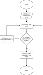

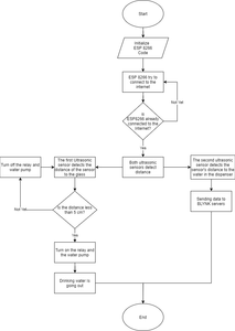

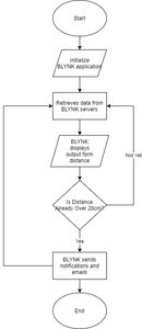

Step 3: Block Diagram and Flow Chart
In this step consist figure of the Block diagram and Flow chart of the system in this project.
In the Block diagram, the PSU breadboard that connects to ESP8266 and Arduino Uno is the same voltage supplier. The PSU Breadboard is an Input voltage to the controller.
In the ESP8266 Block diagram both of the Ultrasonic sensor is defined as an Input. Then the input data is processed in the controller(ESP8266). The output will be the 5V relay that is connected to Water Pump.
In the Arduino Uno Block diagram, MRFC522 RFID is the system input. The input then is processed by the controller(Arduino Uno). Then the controller will send the output to LCD to display either the input is successful or failed.

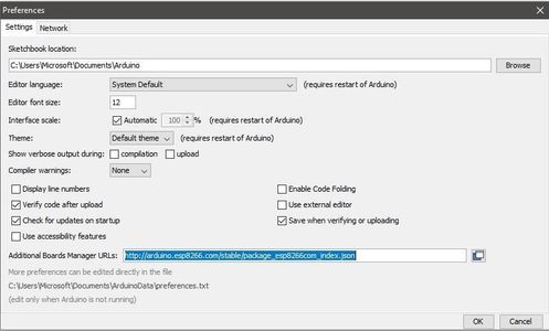

Step 4: How to Install Library for Arduino IDE
In the Arduino IDE
Ctrl +Comma or Go to File => Preferences to Paste (http://arduino.esp8266.com/stable/package_esp8266com_index.json) in Additional Board Manager URLs
Go to Tools => Board => Board Manager => Search "ESP8266" => Install "esp8266" by ESP8266 Community.

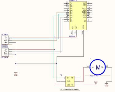

Step 5: Wiring and Code ESP8266
Firstly, wire the component as the schematic diagram as above. The ESP will work as the connection to the WiFi Module. In this system, the data will be sent to the application is the water level of the dispenser.
In the relay, we connected the motor to NO of the relay so that when the relay is activated the motor will start working and pumping the water. For the pipe use a better pipe that usable for drinking and connecting it to the pump so the system could pump out the water.
After connecting the pin of the component to the circuit. The next step will be including the library in the Arduino IDE. Include BLYNK and ESP8266WiFi library to Arduino IDE software. Then use the code below to test the ESP WIFI is working fine as needed.
In the code below is the setup configuration to use the hardware and Blynk software. In order to use Blynk, we use Blynk.begin() in the setup function and give the essential parameter such as Blynk authentication, SSID and pass to access the Blynk project.

In this code below is the main program the water dispenser. the main program will update the system and keep track of the water level. the system will update to the Blynk software the water level by using the ultrasonic sensor. Blynk.virtualWrite will update the data to Blynk software of the water level. When the water level is low by using Blynk.notify() and Blynk.email() the software will send and notify email to the user to refill the water tank.
Blynk.run() is essential in the main function for it is used to connect the microcontroller to the Blynk application

Step 6: Wiring and Code Arduino Uno
Next, we set up another microcontroller that will be connected to RFID and LCD 16x2. By using the schematic above for the wiring configuration.
Pin 13 to 9 will be used for the RFID. FOR the LCD we will use I2C to connect to the microcontroller. LCD SDA and SCL pin is connected to the Analog pin in the Arduino SDA->A4 and SCL->A5. Because the voltage uses for RFID and LCD are different. we connected 3.3V to RFID and 5V to LCD.
In the code includes library SPI and Wire for the communication protocol used by RFID, MRFC522 library is also included because the component that we use as RFID reader is MRFC522, and then we include LiquidCrystal_I2C library because the LCD we use are solder with I2C module, by using I2C LCD module we will reduce the usage of the pin that is being used for the Arduino. In this project, we mainly use the I2C communication protocol to reduce the cost of wiring the components.

in this code below is the main program for the Arduino microcontroller. The RFID will scan the tag/card that has been authorized and shown the user of the card by LCD.
PICC_IsNewCardPresent() this function is used to check either there is a tag/card that is currently in the range of the RFID sensor.
PICC_ReadCardSerial() this function is used to check either the card data could be read or not.
The card/ tag that is being read by the RFID sensor will use the data UID to check either it is Authorize or not. If the card or tag is not authorized it will return an error message through LCD.
