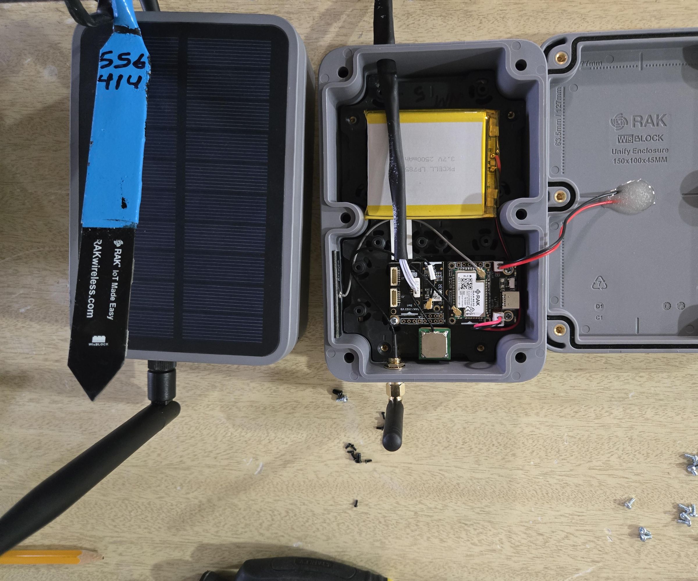

This is just some instruction for a little water controller flow controller I built from a Huzzah to monitor the moisture content in my flowerbed and water accordingly. The code is pretty basic and the physical build is fairly minimal using the Adafruit Huzzah and a HD-38 Soil Moisture Sensor module to keep track of things and make decision and to make things happen I made use of a relay, 12 volt battery and a motorized ball valve. I wanted to power the thing from one source so I just used the 12v battery and a 5v stepdown converter. I also put the built circuit into a decent waterproof enclosure 'cause water...
Below is a set of instructions containing code for the Arduino ide, instructions to flash the build, a component list and the build itself.
Other Considerations...
No solar solution as I am just powering my build through the usb connection, but imo.. adding a battery, super simple; adding a solar charger, little more complicated but doable.
Note the antenna and Lora radio hat that is clearly in the picture and part of my build.. This is literally just a Lora 'feather' or hat for the Huzzah (and other Adafruit spec boards), nothing special going on with it and I intend to use it in the future to propagate the data to a larger lora data network. To be clear... I'm not using it and have completely omitted it from the component list and instructions.

Step 1: Adding Components to the Base Board
Assuming you have all the needed components gathered the first thing to do is solder the extra components and wiring on the base board...
Prep your work area to do a little soldering and grab your enclosure kit (or base board if you are not using the enclosure kit) and remove all the components that can be removed, clean the board.
Solder on the 5V Buck.. we are going to use this to convert the 12V DC supplied from the battery to a constant 5V feed to power the Huzzah.
When soldering the +5V USB pin for the Huzzah notice the inclusion of pigtails (wires only soldered on one end) for use later to power the Relay Switch.
Next solder on the wiring according to the diagram supplied, It is best to solder all the wiring to the back (underside) of the base board.
Quick list of connections to make...
  1. P1+ to Vin on 5V Buck
  2. P1- to GND on 5V Buck
  3. GND from 5V Buck to GND(-) on HD-38
  4. GND on 5V Buck to GND on Arduino Huzzah
  5. GND on Arduino Huzzah to GND on Voltage Divider
  6. +5V on 5V Buck to Arduino Huzzah USB pin
  7. +5V on 5V Buck to +5V(+) on HD-38
  8. A0 on HD-38 to input of Voltage Divider
  9. Center Node (Divided Voltage) of Voltage Divider to ADC
  10. Pigtails
  11. Solder a wire onto the SCL pin of the Huzzah (to connect to and control the Relay Switch)
  12. Solder a wire onto the +12V pin of P1 (to connect to the DC+ of the Relay Switch)
  13. Solder a wire onto the -12V (GND) pin of P1 (to connect to the DC- of the Relay Switch)
That should be all the connections, we can now proceed with some steps to ensure the correct operational values.. Basically we should test things and verify a few values before we start plugging stuff in.
Before putting the base board back into the enclosure housing proceed to the next steps.
