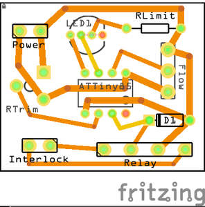

To interpret the stream of pulses from the sensor we will use an ATtiny85 microcontroller, this will count the pulses and when the desired flow rate is achieved it will close a relay, completing the interlock circuit.
To help with diagnostics an RGB LED is fitted, and for configuration an small trim pot is used to set the threshold flow rate. The relay is a small reed relay where the coil current is low enough to be directly driven my the microcontroller.
The centre tap of the trim pot attaches to an analog input, the flow sensor to a digital interrupt pin, and the LED uses just two spare output pins (red, green)
I designed the PCB layout using Fritzing as the components were fairly simple.
Step 2: PCB and Assembly
The PCB was isolation milled using a desktop CNC milling machine, the holes were also drilled by the CNC machine. All components are standard through hole ones, and is quickly soldered together. With the various connecting wires soldered directly into the board.
