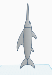

Step 1: Step 1: Designing the Marlin (body)
To begin, create a Tinkercad account by visitingTinkercad. Sign up using your email or log in if you already have an account. Once you’re in, click "Create New Design" to open a blank workspace.
Start by selecting the Paraboloid shape from the menu on the right-hand side of the workspace. Place it on the workplane and use the scaling handles to stretch its height upward, elongating the shape. Then, narrow its width using the side scaling handles to make it more streamlined. This will form the basis of your fish’s body.
Next, copy and paste the adjusted paraboloid by pressing Ctrl+C and Ctrl+V. Use the Mirror tool (found in the toolbar) to flip the duplicate along the appropriate axis. Position the mirrored paraboloid to align with the original, creating a symmetrical fish body.
To ensure the body is solid, drag a Cylinder from the shape menu and place it inside the combined paraboloids. Scale the cylinder in all directions so it completely fills any internal gaps or cavities in the model.
For the top fin, add another Paraboloid to the workplane. Adjust its dimensions to make it thinner and shorter. To refine its design, use another Paraboloid or a Cylinder set as a hole to cut a curve into the fin. Once satisfied, group the shapes to finalize the fin and adjust its size or orientation to your liking. Position the fin on top of the fish’s body.
Repeat this process to create the two bottom fins. Use new Paraboloid shapes and adjust their size, height, and width to differentiate them from the top fin. Position these fins symmetrically on either side of the body, experimenting with their placement and dimensions to suit your design.
For the tail fin, copy and paste the top fin and reflect it to create the general fish shape. Place it at the back of the fish’s body. Use a Cylinder as a hole to refine the shape of the tail fin.
Finally, review the entire model to ensure all components are aligned and proportionate. Make any necessary adjustments to the fins, body, and tail until the fish model matches your vision. Once completed, save your design and export it as an STL or OBJ file for 3D printing or further use.
With these steps, you’ll have a fully designed fish model ready to bring to life!
Step 2: Step 2: Designing the Marlin (Head & Mount)
To start designing the head of the marlin, select a Paraboloid from the shape menu in Tinkercad. Place it on the workplane and adjust its dimensions so it fits proportionally with the body of the marlin. It’s okay if the head doesn’t perfectly align with the body, as this won’t affect the final interlocking design.
Next, to create the bill of the marlin, drag another Paraboloid onto the workplane. Stretch this paraboloid horizontally to elongate it, giving it the characteristic marlin bill. Adjust its position so it extends smoothly from the head.
For the mouth, take another Paraboloid and shrink its size while stretching it slightly to form a narrow shape. Set this paraboloid as a hole using the shape settings. Position the hole at the front of the head to carve out the mouth. Angle the mouth hole slightly if you prefer a dynamic look, or keep it straight for a simpler design.
To create the mounting bracket, start by dragging a large Rectangle onto the workplane. This will serve as the base for the bracket. On top of this rectangle, place three smaller identical rectangles. Space these rectangles evenly along the surface of the larger rectangle. Once they are positioned correctly, copy and paste the smaller rectangles, then convert these copies into holes.
Finally, insert the hole rectangles into the model to serve as insert points for the mounting bracket. After completing these steps, review the alignment and proportions of the head, bill, mouth, and mounting bracket. Make any necessary adjustments to ensure the model looks cohesive and functions as intended. Once satisfied, save your design and export it for further use or production.
