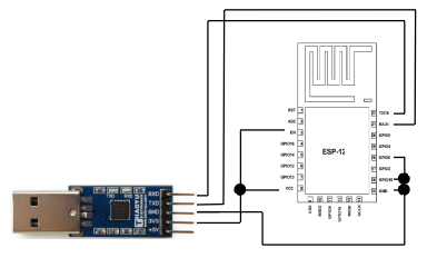

Step 2: Flashing Firmware
For initial flashing of the firmware onto the sensor device, you need a CP2102 USB to UART adapter.
Flashing instructions Sensor Device
Flashing instructions Gateway

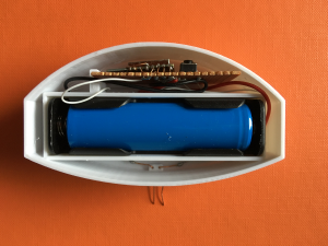

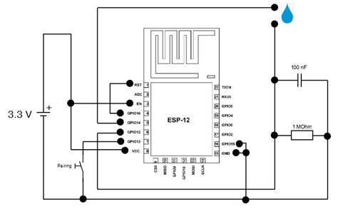

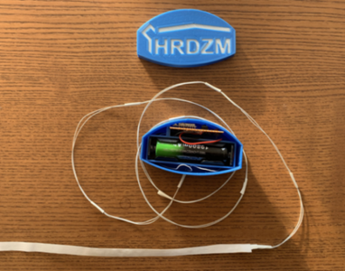

Step 3: How to Wire the Sensor Device
If wanted, a 3D Printable case can be found on thingiverse.

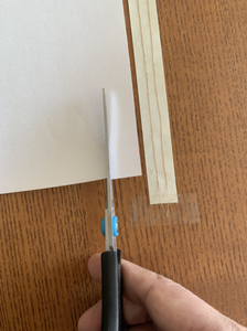

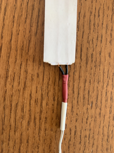

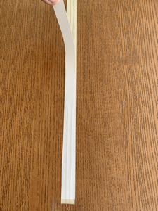

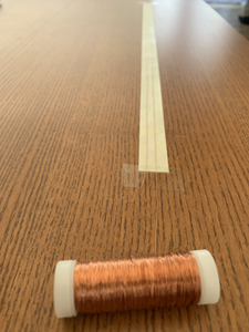

Step 4: Create the Water Detection Stripe
