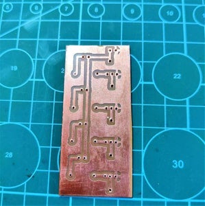

Step 3: LET'S MAKE PCB
Follow the following steps to make PCB using "Tonner transfer Technic"
  1. Take a print on photo paper using tonner powder filled printer.
  2. Cut PCB of layout size.
  3. Use Iron to transfer tonner on PCB.
  4. After tonner transfer successfully.
  5. take a 2-3 spoon of ferric chloride in water.
  6. Place PCB in the solution for 5-10 min.
  7. Clean the PCB with the help of PCB Cleaner.
  8. Drill the PCB using drill machine.
  9. Place all components on PCB as shown in 3D PCB layout.
  10. Solder components on PCB.
  11. Now your PCB Completed.
