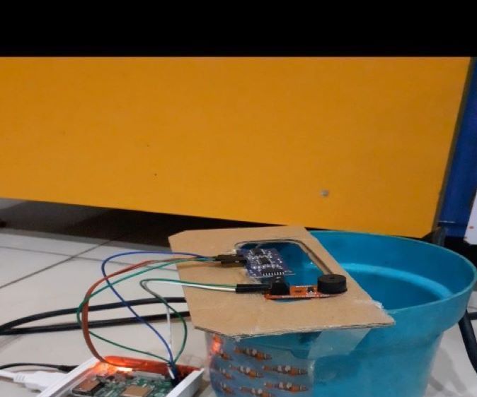

Step 1: Connections
Now let’s talk about the connections of the raspberry pi, ultrasonic sensor, oled display and the buzzer.
Please follow the circuit diagram given.
Connections:
Ultrasonic sensor vcc to 5v of Raspberry Pi
Ultrasonic sensor Gnd to Gnd of Raspberry Pi
Trigger to GPIO 14
Echo to GPIO 15
Buzzer + to GPIO 4
Buzzer – to Gnd
Sda of Oled display to Gpio 2 of Raspberry Pi
Scl of Oled display to Gpio 3 of Raspberry Pi
Vcc of Oled display to 3.3v of Raspberry Pi
Gnd of Oled display to Gnd of Raspberry Pi
Step 2: Structure
· Attach a scale to the bucket.
· Next attach the buzzer and ultrasonic sensor to the scale

Step 4: Testing
Fill water in the bucket. When the distance of ultrasonic sensor from the water is around 4 centimeter, the buzzer will beep, alerting the bucket is almost full and the oled display will show the percentage of the bucket filled.
