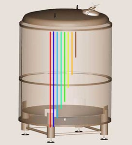

the idea is very easy.
Water conducts electricity poorly
so when the water reach the first sensor level , a 9v signal is sent to BC547 Base
and then the led glows.
i used a net cable and connector for the ease of use.
in my case, my tank is about 50cm high ,so i put a sensor about every 7cm.
